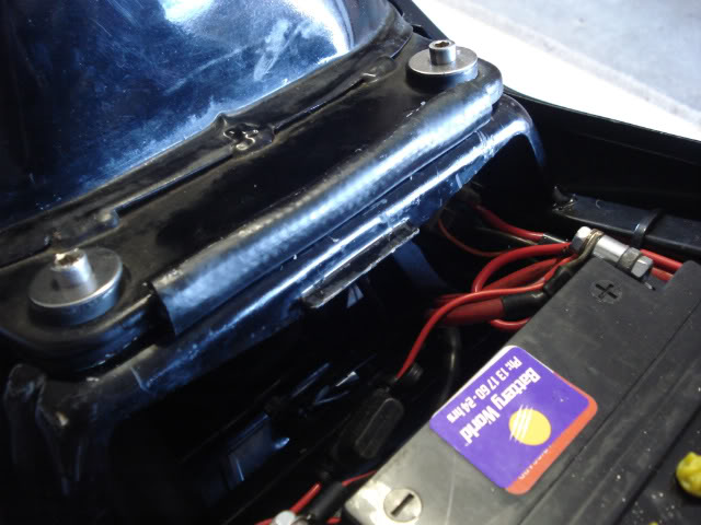

For those that are having trouble with their seat moving forward and releasing from the latch at the back while they are riding,I have a fix.All I did was to cut a piece of fuel hose down the side and slip it over the back of the fuel tank mount,add a bit of silicon to keep it in place,simple.If one piece is not enough just add another over the top.

Now thats the sort of repair I like to see, cheap , effective and not unsightly. Pity you didnt use #8 wire to hold it on but there you go . :P . So when did you move from NZ :lol: .If the rest of that bike is as clean and tidy as the bits I can see it will be a nice bike

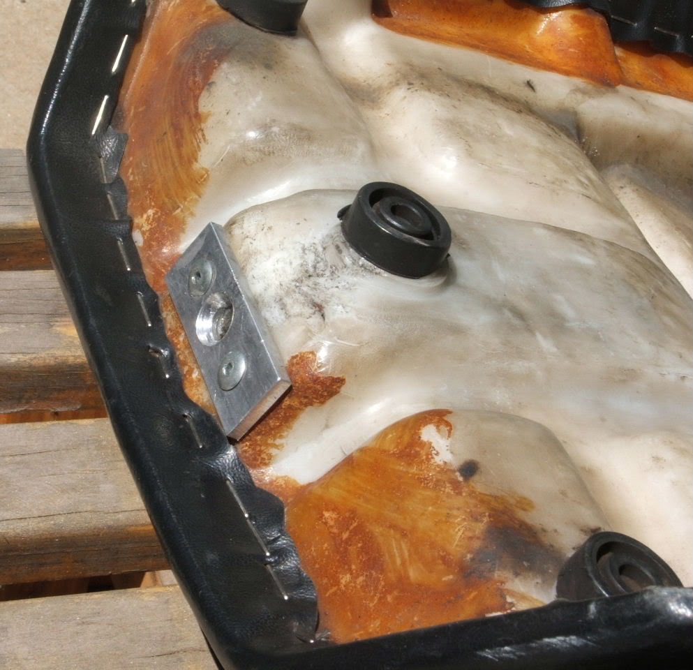

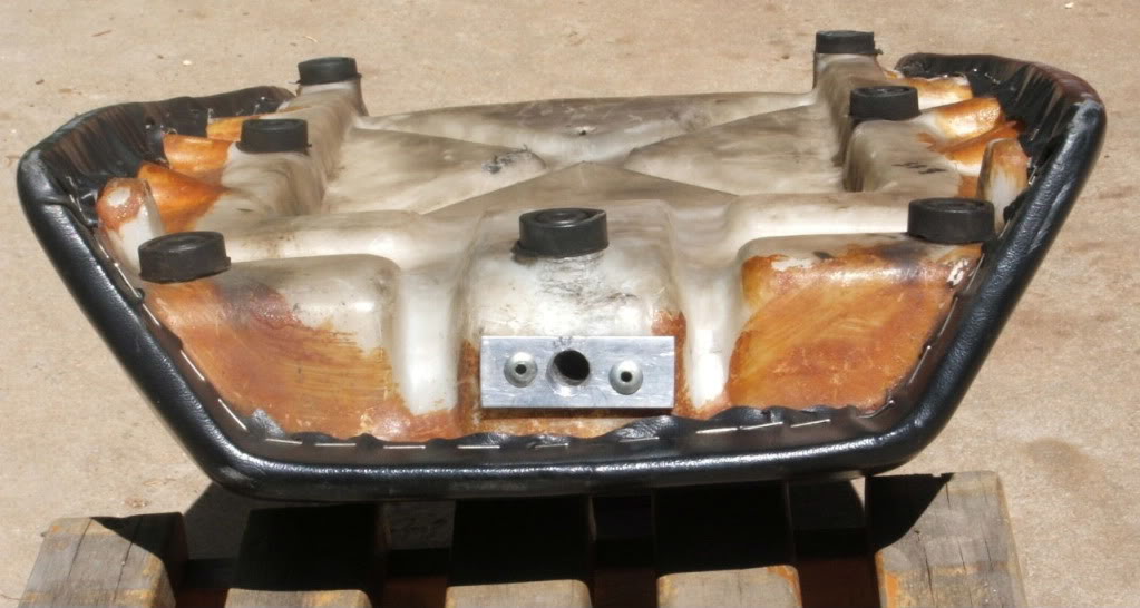

this incident first happened to me, whilst on a ride... a long way from home. unfortunately when the seat swung off, the rubber bumps under the seat tore the wires out of the battery, and killed all electrics. (so there was a bodgey roadside repair to the wiring, and half a roll of duct tape used to secure the seat.)
annywaay... here is how I solved the problem.
It looks a bit rough, but it does the job.

Good to here from you. :beer: Hopefully your rear end was still not in the seat when it hit the ground. Your fix is a bit less agricultural than mine,good work. :thumbup:

I'm planing to go the Duckboy route by putting a thicker plate on the end of the seat.

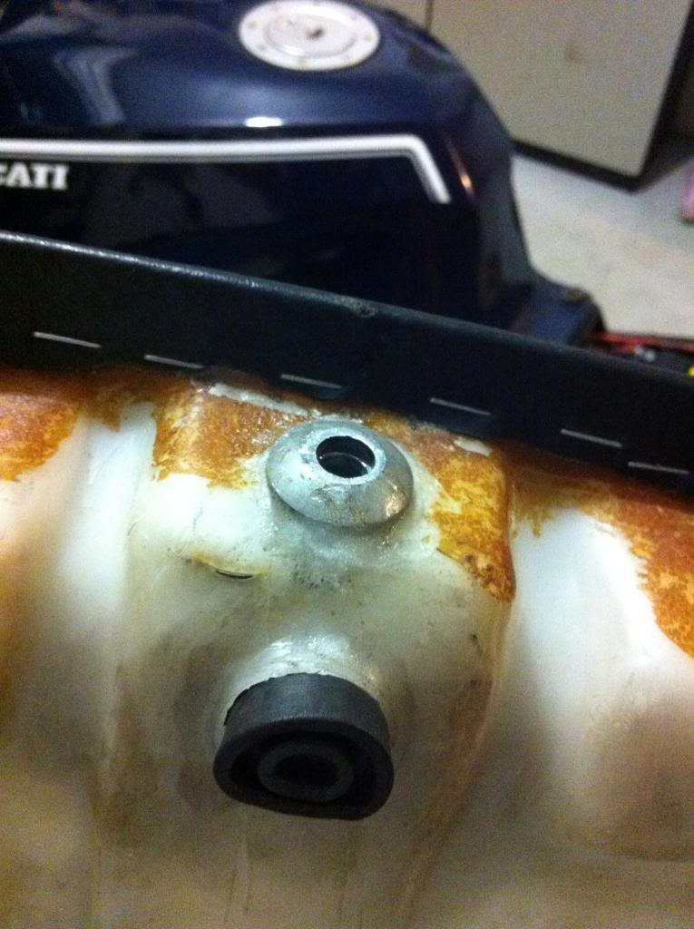

I used the now obsolete muffler retaining bolt, drilled out the hole a bit, and glued it in with some REAL GOOD glue. (Obsolete as I have after market mufflers)
Works real good
