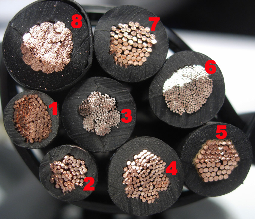

 Post subject: Re: MotoLectric Starter Cable upgrade - what a difference!
PostPosted: Mon Jan 03, 2011 2:07 pm
Posts: 1501
Which one corrodes the least at the terminals, no 8 or what?
My experience is that that`s the main reason bad connection/starting w these cables.
Quality f sure helps but corrosion is the main culprit.
Just my 2c.
