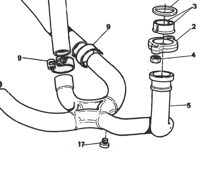

Personally I'd take Higgy's advice and replace the needle and seat just as a matter of precaution as they are most likely the originals and would be due anyway, (sorry forgot to write the needle & seat, thanks Higgy :thumbup: ).
Also wouldn't hurt to remove the screw in plug (17) on the front cylinders header pipe as well, when this happens they can fill with fuel as well I again know this from personal experience.
