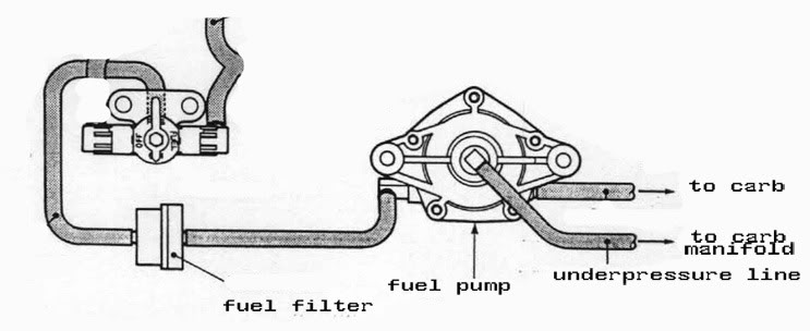

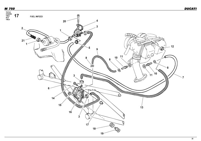

I`ve bought 5 used fuel pumps in the past. All are still in use and working. (Two in Australia, one in NZ and two in Germany). There`s not much that can break down on a vacuum pump. It´s just the membrane and if the pump is installed properly with a fuel filter before it there`s nothing to worry about.
I personally don`t have any concerns buying a used one.
