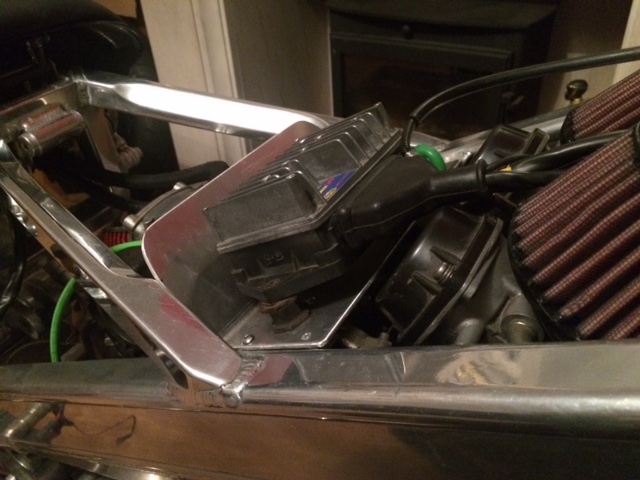

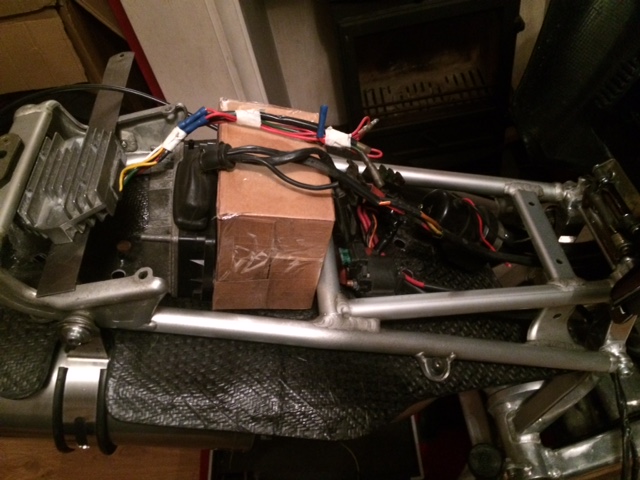

Hi all, I have to places I can put my digiplex on my bike.
Location 1: under the tank between the top of the cylinders at the back of the inlet manifolds & carbs, the digiplex is shielded from heat by quite thick heat sink, sitting on 2 dampers.
Location 2: under the rear seat area behind the battery (brown box) standing upright, the reg rec will probably be mounted on a heat sink more or less were it sits.

Does no one have a view on this topic at all? .......how sensitive to vibration is the digiplex and do you think the heat shield is good enough to deflect heat away from the cylinders?
If not then the digiplex will have to go under the rear seat, comments welcome :)

personally looking at it site 2 would be my preferred option based purely on the fact that you are less likely to have other heat issues regardless of any shielding available.

The regulator position on pic 1 is imo not good. Not only should the cooling fins be in the direction of the airflow but it should be mounted ideally where there is airflow. A good place would be somewhere below the headlight (like on the ST2) or somewhere on the side as on the 916.

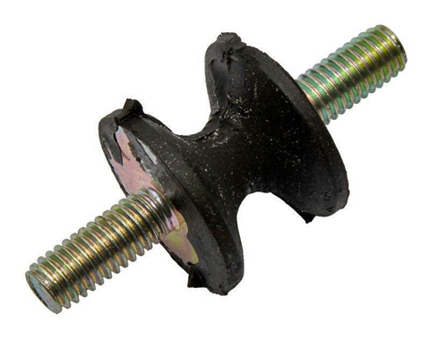

The Digiplex unit doesn`t seem to be that sensitive to vibrations as the large ECU units used on the 907ie and others as with them the silent blocks were changed to a different type. (pic below)
No idea how effective the heat shield on pic two is. The rear part of it is rather high. It might protect the ECU from heat but also negatively influence the airflow it needs to cool down.
The position in the rear might be better. If the regulator is gone there should be space to mount it horizontally and away from the exhaust. How hot it gets there depends on your exhaust. Are those absorption silencers (straight through) or reflective ones. The first are the ones you can look through. These don`t get as hot as reflective silencers as the exhaust fumes exit quicker.
If those are reflective silencers and it gets too hot you could try heat reflective shield or a piece of welding blanket. However a different position with better airflow would be preferable.

Cheers guys, that's the sort of comments I was after, so I will defo put the reg/rec up front on the bike and put the digiplex at the back of the bike.
