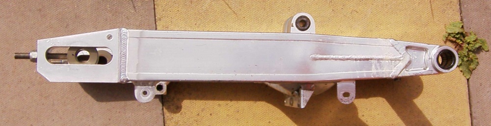

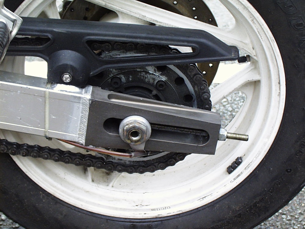

The rear is the thorny problem, and required most thought and effort. A second hand swinging arm was purchased, and taken to Spondon Engineering, in Derby to be modified. The swinging arm is cut just at the point wher the welded on eccentric chain adjusters stop it tapering outwards, and from where the faces become parallel. My calculations had indicated that a 150/80 or 160/80 tyre would need around 1-1.1/4” of extra room, so it would need around 3” of extension in order to accommodate a larger tyre and leave room for chain adjustment, but I asked them for a bit more to be safe. What I got was a 6” chain adjuster extension, using one of their “drag bike” drawbolt style adjusters. That gave me more than enough room to manoeuvre!
File comment: The original chain adjusters gave plenty of room to work with.
The standard wheel, brakes, sprocket etc are all retained, with Spondon providing a replacement spindle, drawbolts and other minor requirements. Because the wheel sits about an inch further back, the standard caliper carrier does not engage with the lug welded on to the top of the swinging arm to prevent it rotating. Accordingly, I had to make up a stop to fit, which I did using a section of 1” square alloy, with a suitable size bolt to replace the lug. This was then attached to the existing boss atop the swinging arm using a section of 90 degree angled alloy. The only drawback to this is that the standard silencer fouled the bolt, so judicious application of a 2lb lump hammer to the back of the silencer created a recess which is unnoticeable from anywhere except within the rear wheel.
The centrestand was modified to include an extra inch of length, so that the rear wheel stood clear of the ground when parked, but I didn’t change the sidestand. It just leans a bit further. Also, as the rear mudguard would have fouled the bigger tyre, I created a little extra room by cutting the mudguard (which is only plastic) from the direction of the wheel centre out towards the angle at the top of the number plate. The whole rear section can then be bent out slightly, and I used a couple of small alloy plates pop riveted to the mudguard sides to keep the position. This was then covered over with a small section of rubber glued to the outside of the mudguard to hide the spacer (in fact I used a piece of old inner tube – the right colour, flexible and waterproof).
Finally, to get rolling again, a new piece of brake pipe was required, as my old braided line wouldn’t stretch the extra inch, and a new chain with five extra links took up the required length in the drive train.

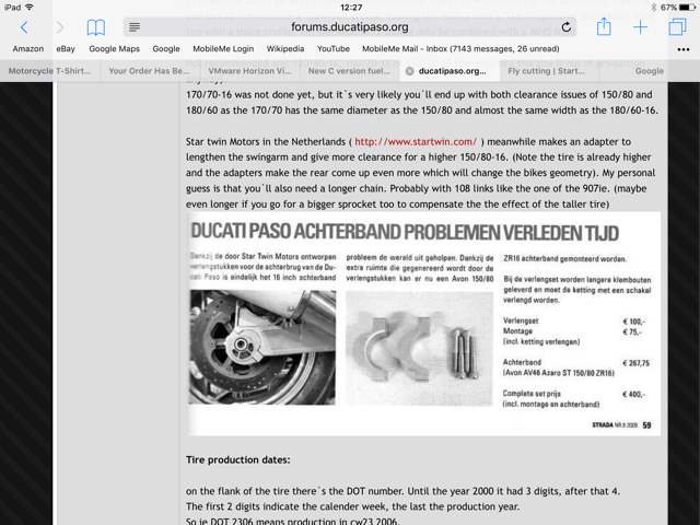

Hi spaggy. This is an excellent post- thanks for sharing. I spotted another rear wheel solution elsewhere see photo. What are your thoughts? I'm a but concerned at how much higher the rear of the bike could be with some chain tension positions. ( does a 16 wheeled bike need even sharper steering!!!!.
Having said all that I'm super interested in the option as I could knock up the spacers on my mill and lathe!

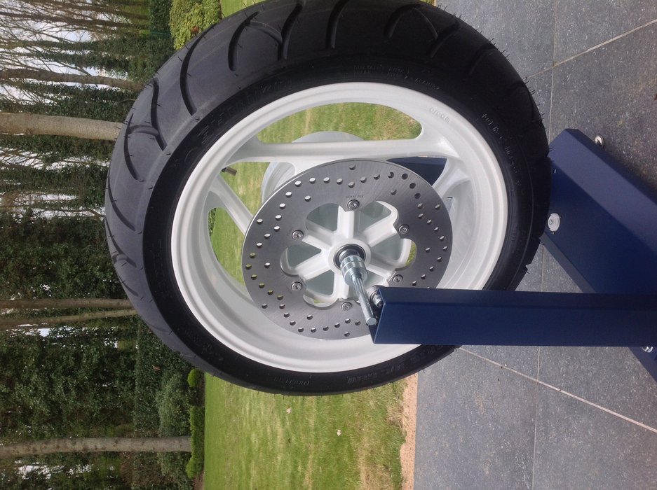

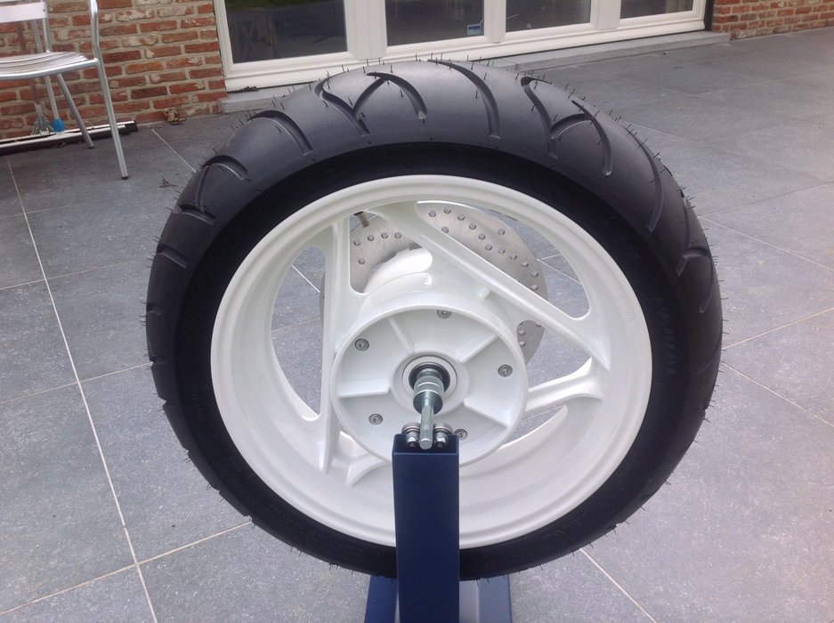

Posts: 261
Hi, I agree with higgy.
Motor Cyclist magazin did test the Shinko SR880 & SR881 only 1 year ago https://youtu.be/bHnmukUJ7aQ
They were impressed how well they worked (sticky!) and for me: these are radials as the originals not cross-ply.
Assume tyre technology (especially radial tyre technology) today is much improved compared to the mid-80ties (Shinko is Japanese and are produced in South Korea - old Yokohama motorcycle tyre division).
Our Paso was the first motorcycle with radial tyre (front & rear) if I'm correct.
So even if the SR880 & SR881 are not the top of the bill, they are way better then the old Michelin/Pirelli's.
And for most countries: they are homologated for our Paso (also no issues with assurance companies if something would happen).
So like higgy said: why bother with alternative solutions.
Better even: only as long as they are sold, Shinko will produce them (and only our Paso uses these sizes).

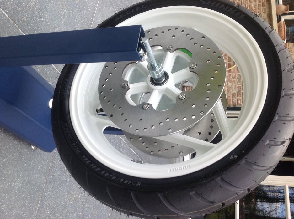

File comment: Front wheel
File comment: Rear wheel 2

You can order them (Shinko tyres) also from Germany:
MC Reifenservice Alfred Shenk (email: schenk@mc-reifen.com)
If you live in Europe and can't get them this is an easy and relative cheap solution.
For my Suzuki I pay almost the same amount just for the rear tyre :lol:
Front tyre SR880 130/60-ZR16 €107
Rear tyre SR881 160/60-ZR16 €120
P&P UK: 1 tyre €22, 2 tyres €25
P&P Italy: 1 tyre €18, 2 tyres €21
They supply almost every country in Europe, I gave these 2 (UK & Italy) as an example.
I have ordered them a few months ago and got them within 3 days on my doorstep.
