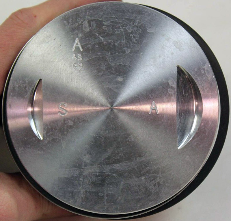

clean the piston crown and see if there are markings. If there is an A and S near the valve pockets A is the intake, S the exhaust side.
The intake valve is bigger than the exhaust valve hence the different size pockets.

Yup, Just as I walked away from the computer it dawned on me that the pistons are clearenced for the valves. A lesson in thinking before I speak.
