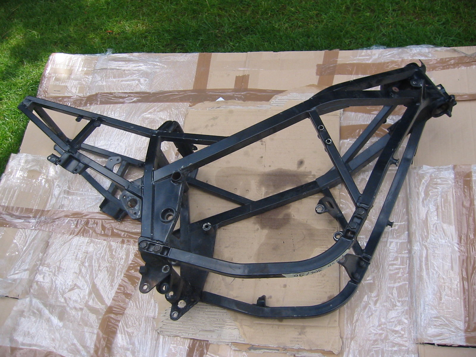

I have fitted a 906 engine in my 750 frame I'm now trying to mount the radiator, I can't find pictures of the radiator mounting brackets, there seems to be a lot of pictures in photo bucket that I can't view. Is there any way I can search or view these old photos?

Hi Mark ( good Kiwi name that :wink: ) , Photobucket recently decided to start charging for image storage , even for those who were free private users , so rather than pay the bastards most peeps just deleted their albums and as you can see anything hosted by PB is now no longer visible . Anyhow I can take some pix for you ( no more than 3 :D ) if you want . Have a real good think about where the back of the front wheel will be when the forks are fully compressed ..... and make sure there is room for a radiator there . I know that when fitting a 17" wheel to the 906 there is a clearance issue so clearly things are tight there . Possible to fit dual rads ?, Ah la mx bikes ( possibly even use mx bike rads ) and the P750 originally. What carbs do you have ( dare I ask )

Thanks Hamish. Some pictures would be greatly appreciated, I have 906 front sub frame I think brackets line up with that but conformation would be good.

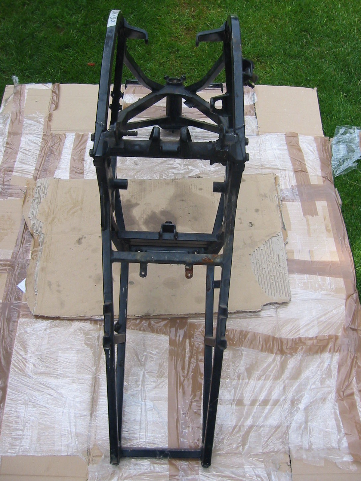

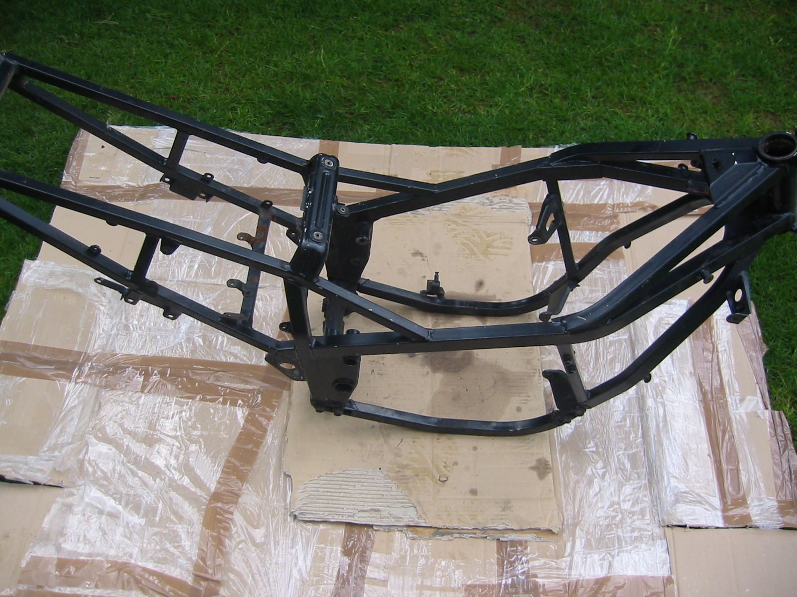

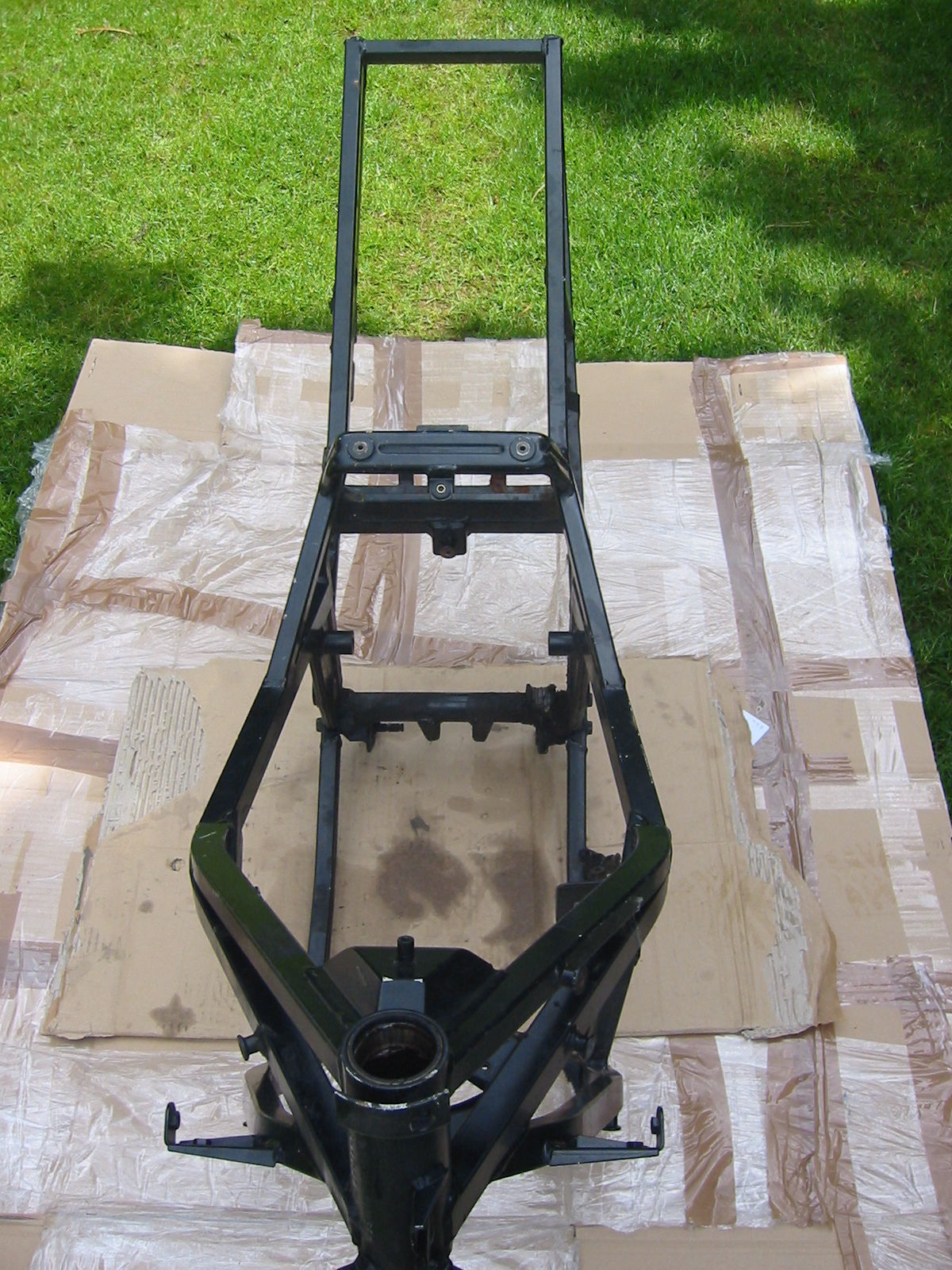

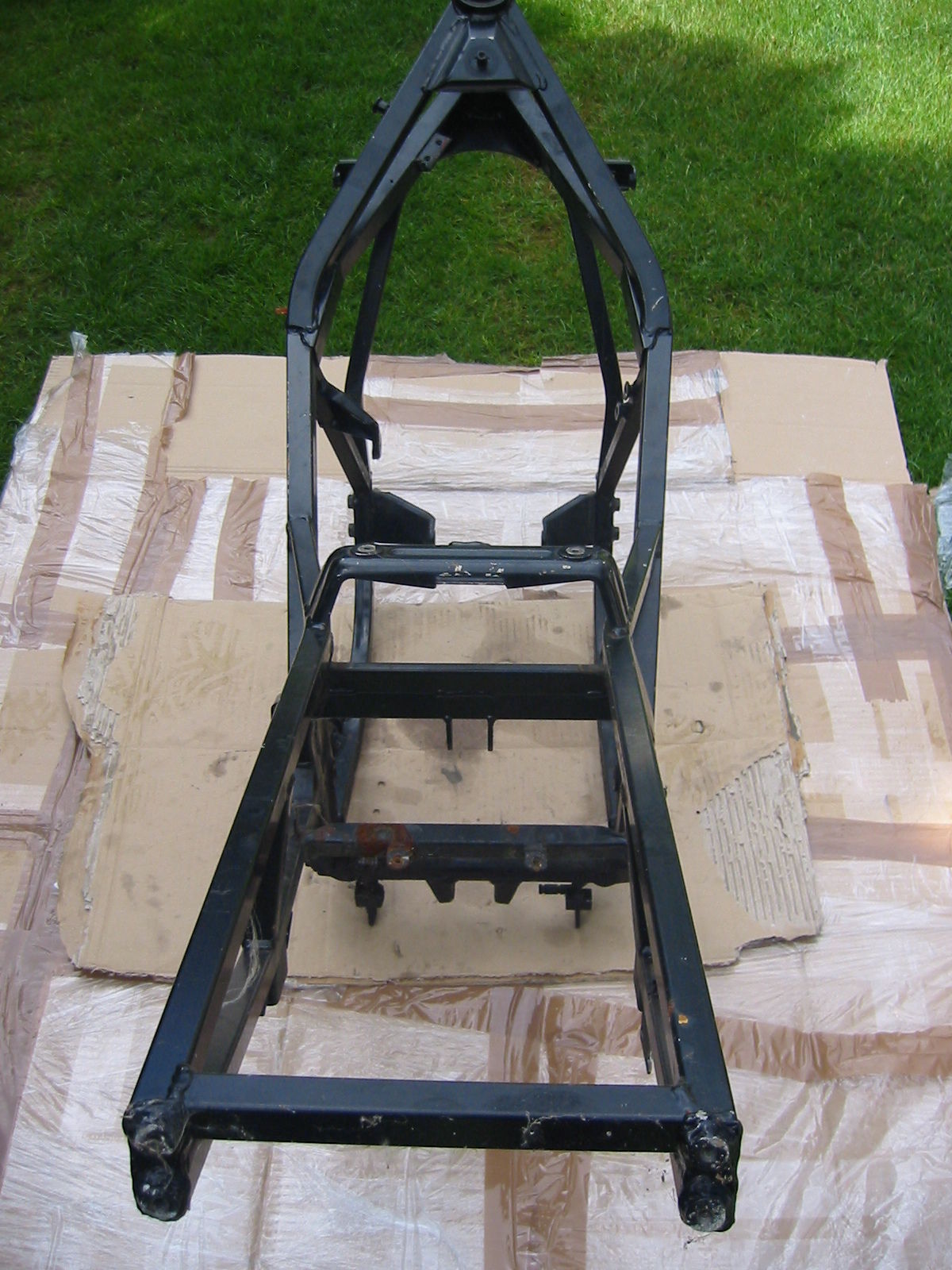

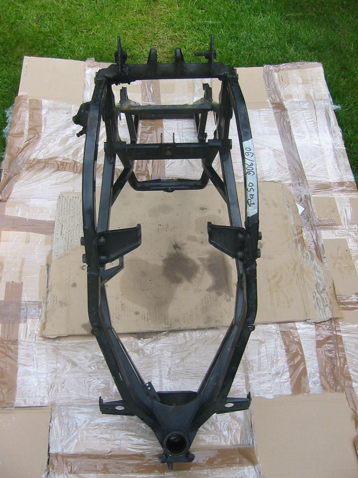

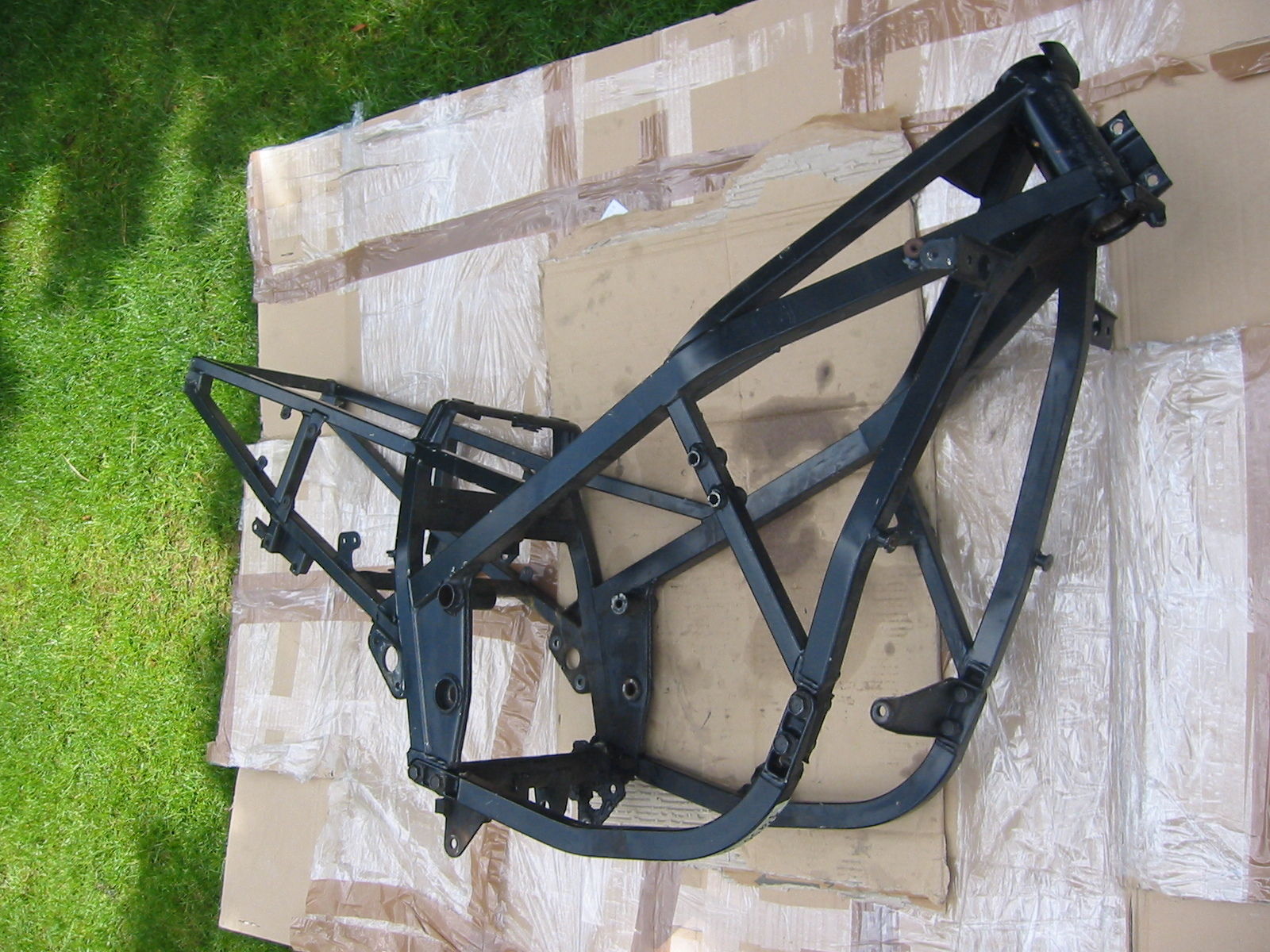

there's a 906 frame on ebay and there are numerous pictures. I've attached them.

 Post subject: Re: 906 Transplant
PostPosted: Mon Oct 23, 2017 11:11 pm
Well that's better than anything I could manage :)

Sweet. Thanks for that.
The brackets are higher up the frame than I was going to mount them.
