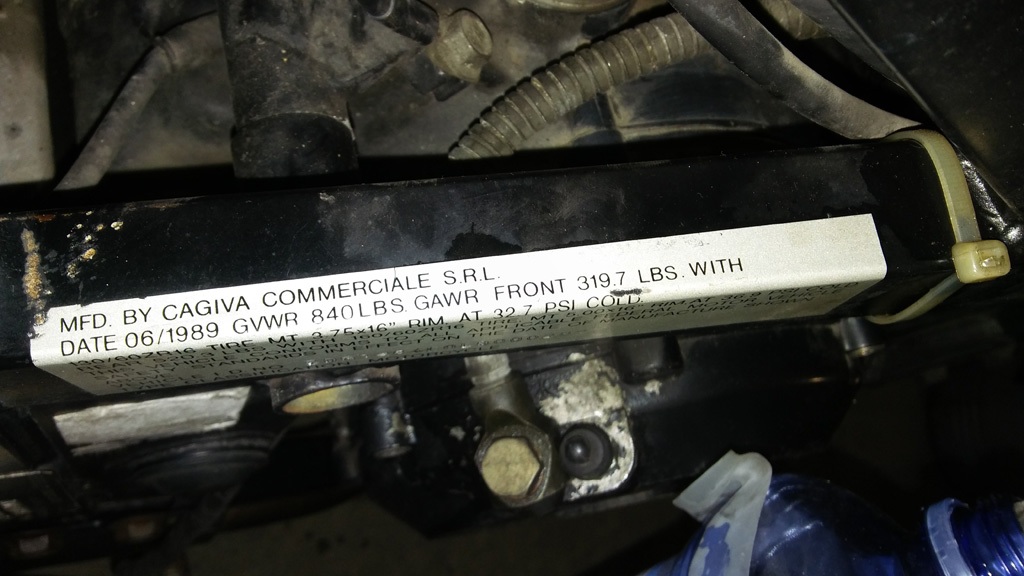

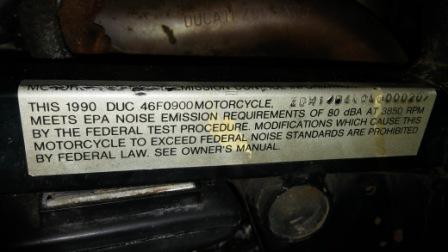

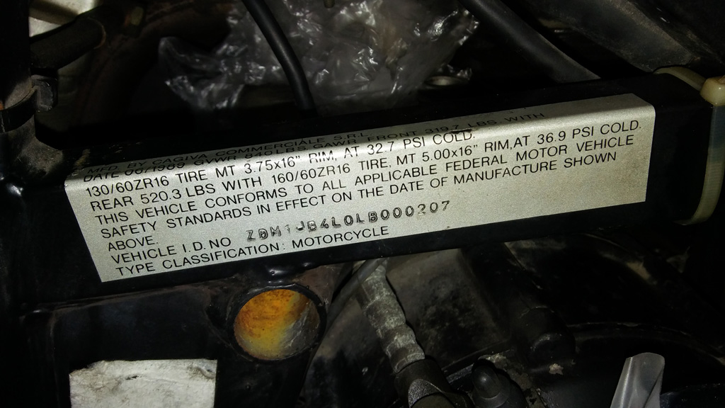

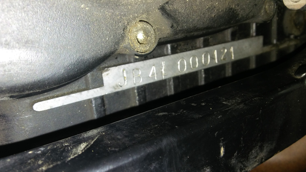

Hello, I see I'm not alone confused by VIN. I did not help with Ducati, and one of my companions found a single record for the motorbike that was made in 2.October 1989, June 1989 and according to the vin is a 1990 model.
The number on the engine makes no sense at all :banghead:
I'm sorry, but it translates it for me google, so maybe it makes a little sense what i wrote :-D

Can't help with the number unfortunately. I find it interesting that is says Cagiva on the sticker and also that it is on the right side of the frame. Is't it usually on the left side?

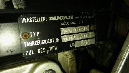

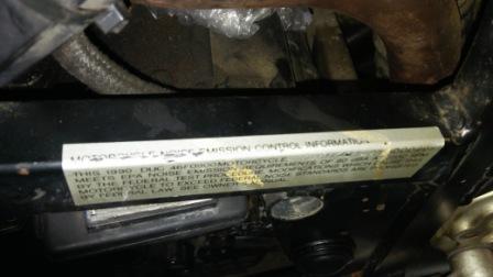

On the right side there is a metal label with VIN and on the left side there is another sticker
