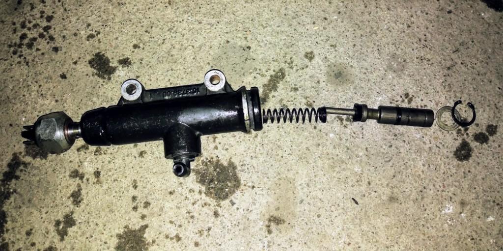

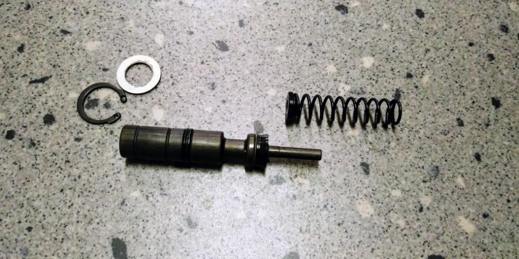

Hi, can you tell me which rear brake pump would fit the 906 Paso?
I wanted to rebuild only the piston, but I have not got anywhere in the EU, I will probably have to replace the whole brake pump

PostPosted: Sun May 06, 2018 8:31 am
Brembo seals and repair kits can be bought from KTM dealerships. Make sure that the model has the same master cylinder.

Location: Czech Republic
my piston is 11mm and they do not have a supply

PostPosted: Fri May 11, 2018 10:59 am
you can still find the complete pump.

PostPosted: Wed May 30, 2018 10:53 am
For information. Repair kits for the Brembo PS11 rear master cylinder (and many more) are available from Gutsibits in the UK.
I ordered here, thank you for the tip
https://www.stein-dinse.biz/Ducati/Brem ... 16254.html
I have a mounted brake and it works as it should :)
