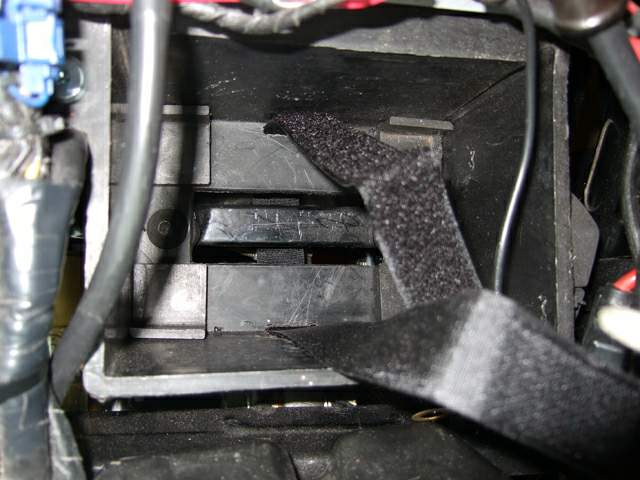

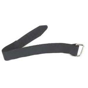

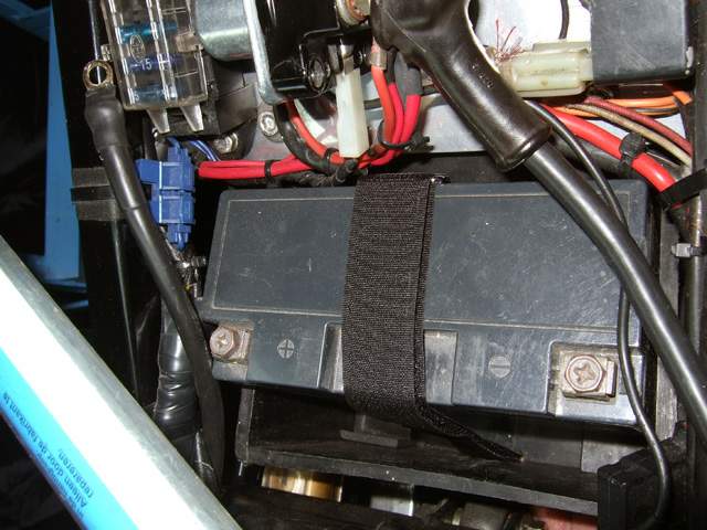

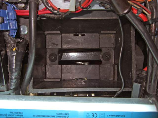

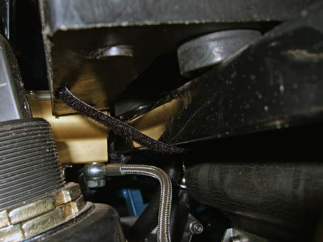

Like Rogero I stuffed something next to the battery so it wouldn`t move. I gave a velcro strap a try now (60-75cm is a good length). Made two cuts on the bottom of the battery compartment. The one on the rear side shouldn`t be exactly on the edge as on the bottom side there`s the plastic extension where the rubber mud flap is mounted to. Actually you can see the center bolt through the rear cut.
