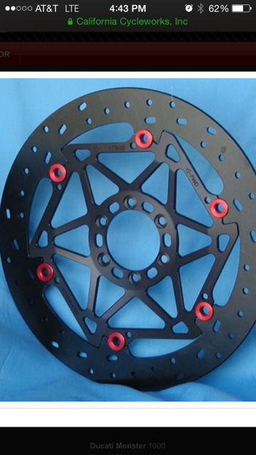

I am going to use the Brembo Goldline ( P4 3--34 with 40mm spacing)) calipers that I purchased from Bevel Heaven along with Brake Tech Axis Iron 320mm rotors that I purchased from Chris Kelly at California Cycle works.I had a set of 1992 forks purchased from EBAY but when they showed up someone had ground the caliper mounting lugs at some point ( who knows why) and rendered them useless, so I sent them back for a refund.I am now looking for a set of lower fork legs to make this work out.In the meantime I will be using 300mm EBC Pro-Lite rotors so I can at least ride the bike.
After I get the forks I need I will switch over to different pads and the Iron rotors.
