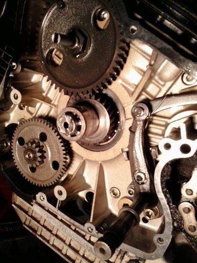

I finally got round to repairing the black menace, and after a good night of wrenching, I am happy to say there was nothing wrong with the sprag clutch..
Unfortunately I am not so happy to announce the real problem: a sheared off crankshaft... :cry:
The reason the starter freewheeled was that the flywheel broke loose from the crank. That, too, explained why it wasn't charging anymore of late. The rectifier was proably ok, but the alternator rotor was lying around disconnected in the stator.
so... Anyone in W-europe who has a spare crank lying about? Spare engineblock maybe?
But on to the more important question: does anyone know what other Ducati models use the same crankshaft? ST2 possibly? maybe 900SS of even 4v 916-996-998 models?

 Post subject: Re: Starter (sprag) clutch replacing
PostPosted: Thu Jul 02, 2015 1:12 pm
http://www.ebay.com/itm/1991-1992-Ducat ... 0772252998
PostPosted: Fri Jul 03, 2015 3:15 pm
Joined: Wed Mar 04, 2015 10:14 pm
Posts: 9
That looks like a good deal indeed.
Now for the next problem: when opening the sump, the shafts, and especially the new crank, have to be shimmed up right. That'll be a first time for me too. So: anybody a how-to, or some tips & tricks?

PostPosted: Wed Jul 08, 2015 12:23 pm
Posts: 1501
Crank should be shimmed w 0,30mm freeplay acc to manual.
BE AWARE: You need a real good puller f primary gear,
VERY hard to dismount!
If you do it yourself, it comes flyin off w LOTS of force,
could damage yourself or parts etc 5-10m's away!!!
Professional help safest....
Always clean threads before flywheel mounting
& always use medium loctite. That is, EVERY time...
