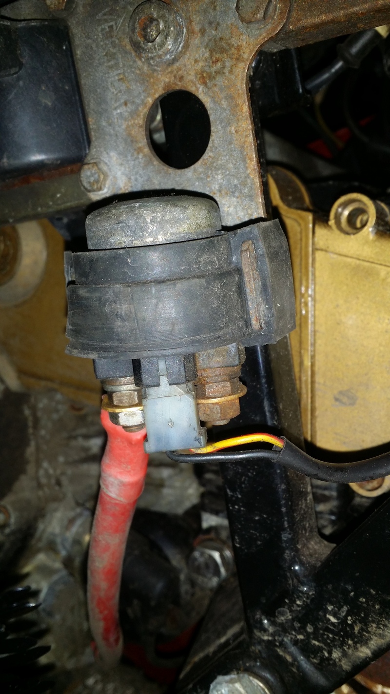

Finally found the culprit a loose connection here with the plug in point has meant that as soon as I started the plug moved and killed the engine. Happy days as soon as I work out a best solution to replace or crush tighter the connection point.
20160605_212918_zpsfm3dr8fg.jpg [407.01 KiB]
Not downloaded yet
 Post subject: Re: Something ain't right..... ?
PostPosted: Mon Jun 06, 2016 8:36 am
The solenoid plug falling out is a well known weak point on Ducatis. Later models use an in-line plug/socket that lock together. I'd clean up those solenoid terminals while you're in there.

I have a zip tie on both my ST and the 907 around this bugger.
PostPosted: Sat Jun 11, 2016 9:48 am
Posts: 50
Location: Switzerland
zip as well, cheap, reliable and no more worry.
PostPosted: Sat Jun 11, 2016 2:23 pm
Actually mine was zip tied on but taken off to show it a bit more clearly. The internal pins had become opened up so even though tight pressed on. the contact was lost and the engine died. that was the most annoying feature one minute fine and then dead. then the starter was dead, then all well. I thought it was a fuse or an earth and changed a few bits. ended up a case of elimination and as we all know poking around a Paso means removing all the bloody panels again and again and agai..........
