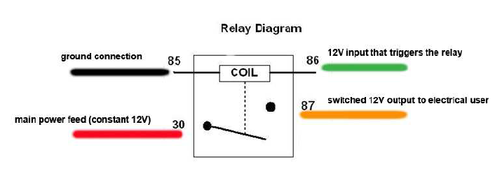

I was about to do the wiring mod that involves adding a relay to isolate the ignition switch from the main power. This:
https://app.box.com/s/64zvqpl6sf303gt44wu6
The images and comments below illustrate my confusion. There are various versions of this mod description scattered around the forums. Most are unclear about how to wire this relay. I found one write up regarding the Paso 750 that I thought spelled it out:
http://www.desmodemon.com/paso_project_5.html
Maybe this is obvious, but, as usual, it wasn't to me, and the description linked in the 907ie FAQ could mislead someone who is electrically challenged, like me.
Carry on.
File comment: The main diagram of the mod in the 907ie FAQ link shows the new relay, with pins not marked.
File comment: The next page in the 907ie mod link has an image of a relay with conventional pin wiring. However, I don't think this is how the relay should be wired in this case.

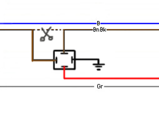

File comment: An image from a document in the Paso 750 area called [b]The Paso Project [/b]seems to show the correct wiring pattern, although you don't need a 5 pin relay. This page, middle diagram:
Bill
91 907ie
Buckeye, AZ.

Hi Bill.
The relay is going in to take the load (current) off the ignition switch. The contact of the ignition switch cops the brunt of it, with everything except the starter current going through them. I don't known what the current rating of the switch contact is, but they were designed and built in the 90's using that era material. The contact rating of a relay can vary, and even the standard car relay can handle 10 to 15 amps with little trouble. The idea of the mod is to use the crap contacts of the switch to turn on the relay contacts, which then has the capacity to run the bike. The coil resistance of a car coil is relatively high, so current required to make and hold the relay is low, which takes the pressure off the ignition switch.
Hope this helps as an explanation. If you need a bit more info, drop me a pm or another post here.

Great stuff, Nick. Can you confirm the wiring of the relay is as shown in the last image and not the one in the actual 907ie file?

Oh, so it will work either way. My electrically challenged mind finally sees that. In retrospect, it seems obvious. Sorry to be polluting the forum with my confusion. You spelled things out so even I could understand it. Thanks.

Yes, now I see it is a bit odd that the Paso 750 document shows 30 swapped with 87, but I get that it makes no practical difference.

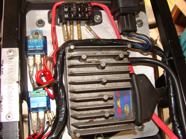

And one other questions... What would be "the proper sized wire" for the power wire in this case?

There is a minimum size , and most manufacturers hit that every time . I use 4mm for heavy stuff like headlights and coils and charging system , and 2.5mm for the rest . The idea being that the larger the cross sectional area of the conductor the less voltage drop .
I use one relay for the main relay but the second is for the coils and magic box ..... I have 2 more up front for the hi low beams ........probly a bit of over kill :)

Oh, the coils. I saw that the "Paso 750 Project" included a relay for them as well. I believe the 907ie ignition relay covers that. I'll check.

Yeah , I keep forgetting the 907 is different there so,probly not needing a relay for that
