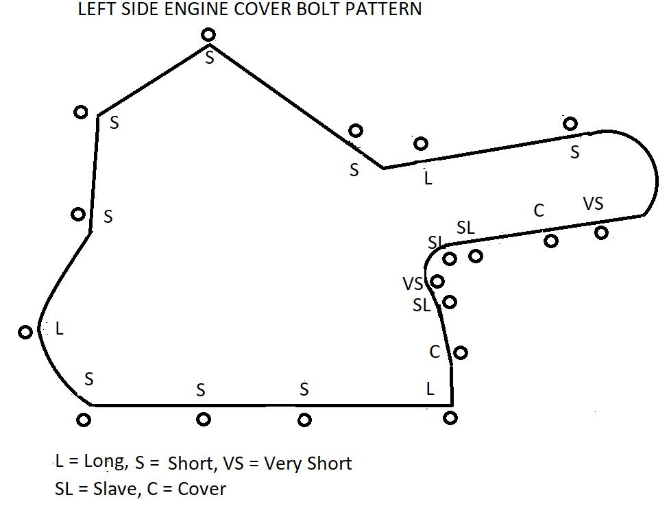

I decided to replace the starter on my 907ie. I searched here and elsewhere and found no comprehensive description of the left engine cover removal process for this model or any with the same motor. Maybe this is so obvious it doesn't need a detailed guide, but I felt the need. I got several tips here and found my way through the job. Here's my step-by-step guide. Please add your corrections and comments, and I will update this post.

9. Remove the 13 cover bolts. Note there are 3 different lengths. Refer to bolt pattern image attached when reassembling. I didn't pay attention to the sprocket cover and clutch slave bolt lengths, setting them aside separately.
