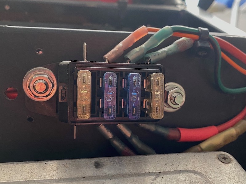

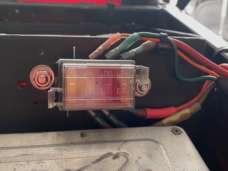

When mine fell apart I used a Narva 54420BL. I used insulated spade connectors and bent the terminals a bit for clearance.
