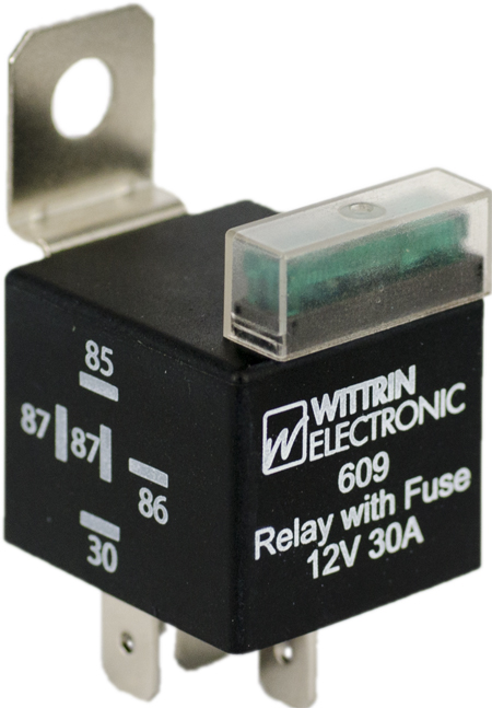

If hard to find such relay, it is very easy to put line fuse holder and suitable fuse to it, as that fuse is only IN SUPPLY SIDE of relay main wire to relay contacts. This is not anykind "rocket sientics" at all :lol:

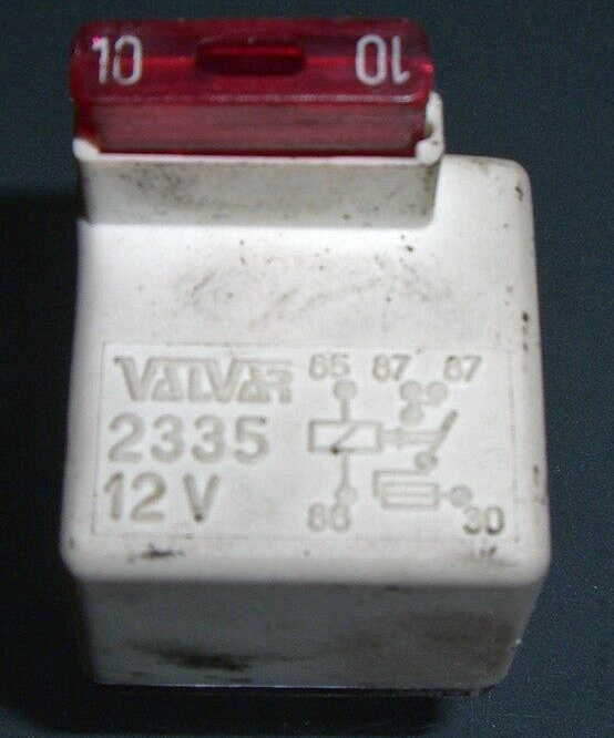

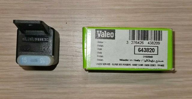

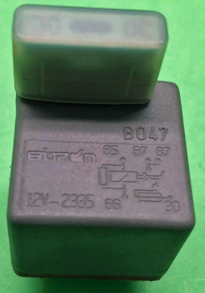

It's not hard as you can order it from Stein Dinse (with some delivery time) and you can find the one from Wittrin and Valeo (Italamec), too. No problem. ;)
A normal dual outlet relay in combination with an inline fuse would work as well. :thumbup: The question is if one would want to cut into the wiring harness. To some electrics is witchcraft. ;)
