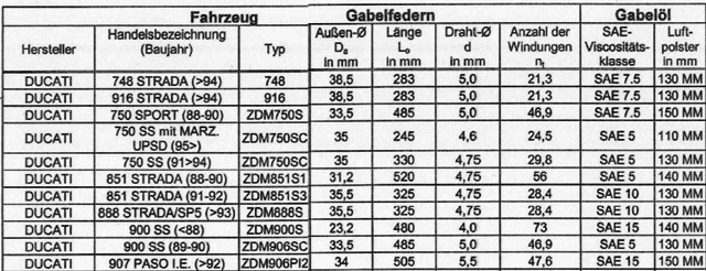

I`ve been going through countless (TUV) documents to find some infos but the only thing I found is this from a WP homologation document.
It`s not really helping as it only lists the 907ie and for a proper comparison all springs should be from the same manufacturer. You can only compare the Sport & 900SS.
However, Da is outer diameter, Lo length, d wire thickness, n number of windings (fork oil and air gap)
