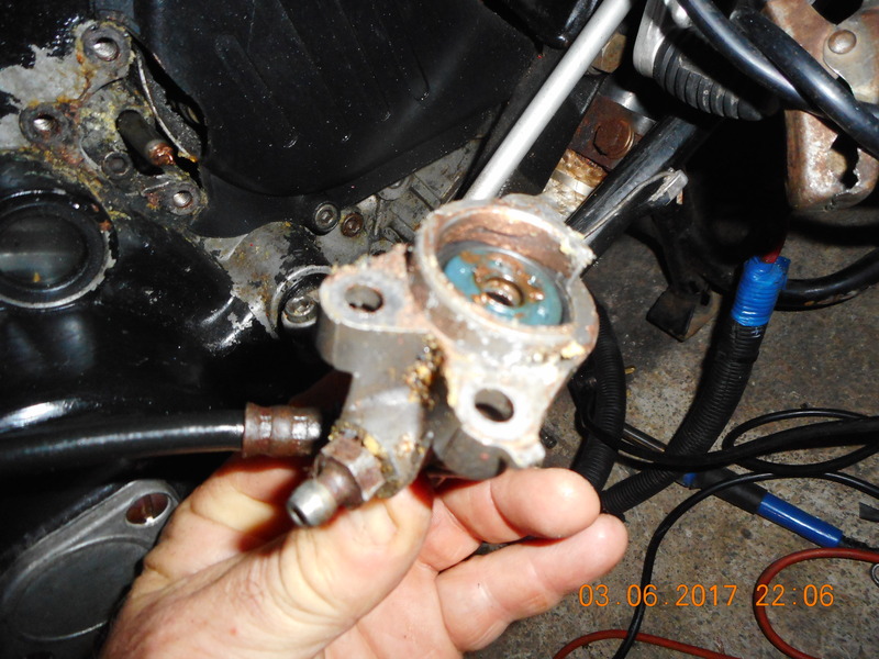

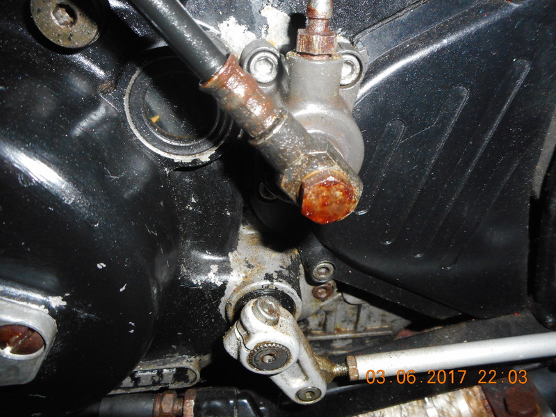

Any chance you could post a photo of your slave cylinder on here. These are some of my slave cylinder which was fitted to the bike from new although this was replaced like for like about 5 years ago. As you can see it is not the same as yours apparently as I never had that outer accordion seal you speak of.
Which may answer your question though as mine does not suffer from it's absence either.
There are no seals that attach to the clutch rod and I cannot see how the accordion seal will fit either as this slave cylinder is a close fit on the outer casing.
I asked at my local Ducati Dealer for the seal kit for the 907ie and the kit I received was as fitted so I assumed this was a standard fitting.

I will take some pictures this weekend. Mine looks like your pictures. The accordion seal sits between the slave cylinder and the block. The seals I am talking about are on the clutch rod, when you pull the rod out, there are two small seals, I am not sure if these are the seals that need to be replaced. Thank you for the pictures! I will post mine this coming weekend.
