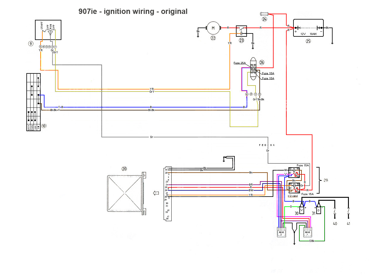

So I replaced all of the fuses in the fuse box and on the two fused relays. I cleaned all the connections I could find and still no start. However, I did disconnect the wire to the solenoid and it gets 8V which is exactly what I was getting at the plug going to the fuel pump at the bottom of the tank. What would cause it to be 8V instead of 12V? Also, I noticed that when I hit the starter button, the battery light on the dash blinks, so something is happening when I hit the starter switch. Is there some way to confirm that the starter solenoid is bad? Thanks. I think I am getting closer.

Again, have a look at the wiring diagram. The two fused relays and the starter solenoid are connected directly to the battery. Their switching voltage comes from one of the two 15A fuses in the fuse holder. Follow its brown/black wire and you'll see that the current passes the ignition switch which connects to the bigger fuse (blue wire) and then to the battery. Measure the voltage of the battery, then at the 25A fuse and at last at one of the two 15A fuses. If there's the 4V voltage drop between both it's caused by the ignition switch. That's a very common problem on the other Paso models.
As for the starter solenoid. Disconnect the cable to the starter and connect your voltmeter instead. Then get a wire and connect the battery directly the solenoids switching input hence the one the start button/yellow-red wire connects to. 8V may not be enough to switch it therefore create a direct connection to the battery. (It doesn't matter if you remove the yellow-red wire or not). The relay should click and you should read 12V. If you read nothing it's not good anymore.
If it switches the 12V through, the starter (when connected back to the solenoid) should normally turn over the engine. If it doesn't remove the spark plugs and try again or better put the bike on the center stand and in gear, turn the wheel by hand and see if the engine actually turns over.
If the engine is free and the solenoid it tested ok the last thing I would do (mainly out of curiosity) is measure the voltage output of the starter solenoid towards the starter motor when hitting the starter button. Just to see if the voltage remains stable or is pulled down. The result actually doesn't matter. If the starter doesn't turn if full voltage is applied it's defective.

Good, so the starter is ok. The issue remains the 8 volts. So measure the voltage at the fuses in the fuse holder!
There's no need to put 12V on the fuel pump directly. The fused relay will do just that once it gets the voltage it needs to switch. And of course if it's ok.
If you would connect 12V directly you'd only see if the fuel pump works. The bike wouldn't start as you'd have no spark.

I could tell you or you could find out yourself if you finally had a look at the wiring plan. ;) However which one it is isn't important. There are three in the fuse holder. A 25A and two 15A. The two smaller ones are connected so you'll measure the same voltage. What do you measure on the big and what on the small fuses? (ignition on) It should be the same. I'm certain it won't be.

Not sure what more info you're looking for. Get a volt/multi-meter and measure the voltage on those fuses. Just do it! :lol:
Here's a picture of the ignition wiring only.
Starting at the ignition switch (10). The blue wire connects to the 25A fuse and that directly to the battery. The ignition switch switches the 12V through (Bn/Bk wire) to the two 15A fuses. From there the 12V get to the kill-switch and via the grey wire to one of the fused relays. So switching on the ignition activates relay 1 which wakes up the ECU which then activates relay 2 which forwards the 12V to the coils and (what is missing in this pic) the fuel pump. Before you do anything else or try identifying the relays make sure that there is full battery voltage on every fuse in the fuse holder. That is crucial for everything following. Checking the relays is only the next step.
