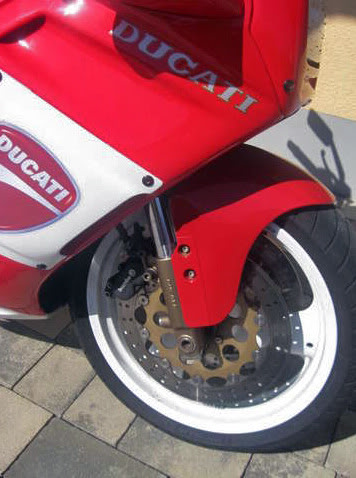

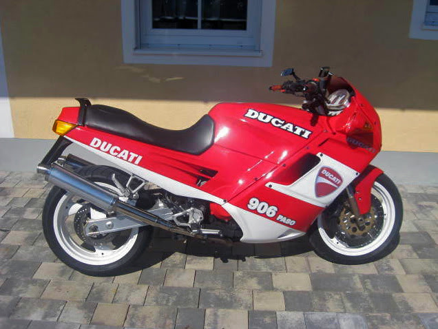

That bike above is so low in the front. No wonder there are clearance problems and quick steering. I wonder about the negative effects that come with it though.

I`m not referring to your bike but the one linked above.
I doubt very much this has the original height in the front.
I had a Showa fork once and it was quite a bit shorter than the one of my Paso which would explain these photos.
An original 907ie as direct comparison. Just look at the distance from floor to lower fairing and mudguard to headlight fairing.
