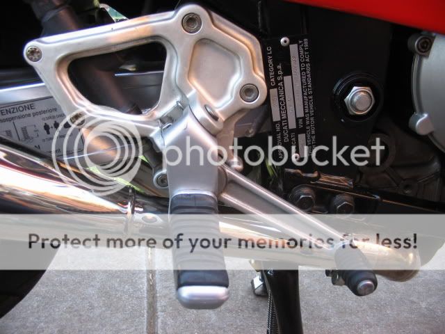

Hi du907,
Follow up to my privious reply: Footpegs lowered by 50mm or 2 inches.
I just noticed the entry by jcslocum `How to insert pictures`, so here they are.
This bracket I made, used the original mounting holes. It has a fold on one edge, just for strength. The gear shifter was adjusted to suit my usual position by adjusting the length of the connecting rod. From memory, I may have slipped the connecting rod bracket off the spline to get the shifter in the ball park first.
Also after I did this, another problem arose, the gear shifter arm hit the side stand.
So I made a side stand which tucked in closer to the frame rails.
I made it slightly longer, as I felt paso`s (owned 2)and 907`s (on my second one) allways leant over too far anyway.
This side was also a challenge. As the rear brake actuator was already close to the staintune, I made a `lowered foot peg`.
This involed starting from a solid block of steel and cutting a slot in the middle for the spring. Then i just shaped it similar to the original. To lower the peg itself, i welded on a piece of stainless steel (so it wouldn`t flex) to the block.
This was when I bought a spare foot peg off ebay.
I cut part of the peg off, where the spring goes through, just befor the rubber part. It had to cut at the correct angle to sit write on the flat piece of stainless.
I neally stuffed this part of the operation up........
The cut off peg was attached to the stainless extension by some metal screws drilled and tapped into the aluminium.
Another problem arose. To lower the foot brake arm to suit my usual position. I wasn`t going to achive this with the small adjustment on the actuator pin inside the slave cylinder. So I made a slightly shorter pin. I just copied the orginal using a piece of stainless rod the same diameter.
Sounds like a lot of work............It was.
But it was a labour of love!
Hope this helps to give you some ideas.

Great pics. Exactly what I was looking for. Now I will have to come up with a similar way to fabricate my own. I especially like the way you did the left side, gear side. That is basically what I had envisioned it. I was thinking of using a aluminium plate there but the basic idea is the same.
