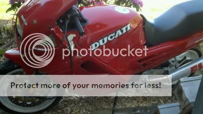

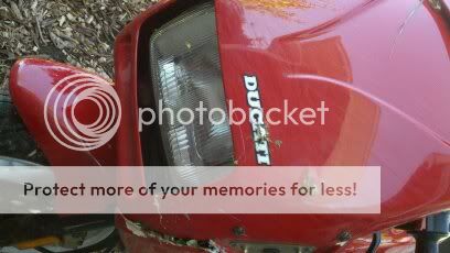

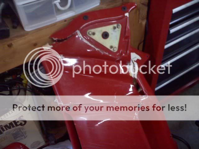

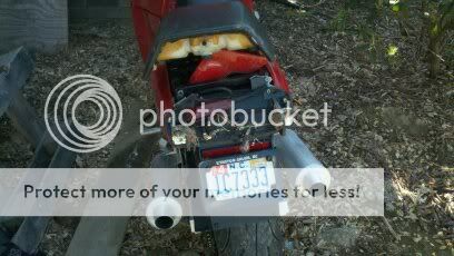

I have to agree on leaving the sidestand down can cause you to wreck. I did exactly that two years ago coming up on the end of this month. I had stopped to look at a map with some friends, was in a hurry, and took off. Before anyone could catch me came up on a left hand curve and leaned over and the stand caught in the fresh pavement and dug in. It leverage the tires off the pavement and I lost control and slid across the road into a ditch. Tore the bike up. I fixed the mechanicals last year, had the forks and front wheel straighten, new triple clamp lower, new subframe for the headlight and instruments, new headlight, etc. I had to buy some used body panels. The only panels I could use are the two side panels that run along the bottom of the seat, all others I had to replace. I ordered new decals from the UK. I am having the parts repaired and painted. I should get all the parts back this week and I will put the bike back together. I'll post pictures of the finished bike later.
This is what it looked like after the wreck. I could'nt move from a chair without help for two months. I still can't bend my knees well enough to ride hard or long distances like I could before. Going down steps is still hard to do.
