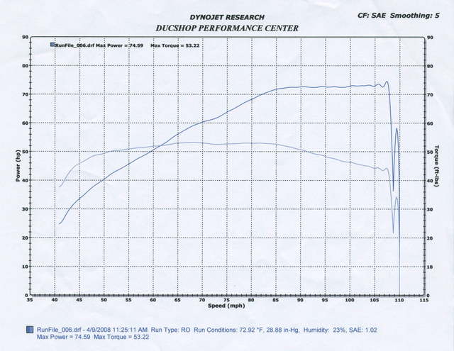

I have two Dynocharts. I think one came from the forum and one I found in the internet. Both show 73,4-74,5hp at rear wheel. So the 78hp should be fine.
Other (higher) values were probably measured at the clutch or driveshaft. It`s like the P750. It`s often mentioned with 72hp, if you check german magazine tests, they usually stated 64.

looking at G's secong graph...is that the torque figure, it doesn't look right, max torque @ 2500rpm...
this 907 must of been fitted with a diesel engine :dunno:
Cheers Claude.
'92 907...numero 2046
'92 851...in progress
 Post subject: Re: How many Horsepower
PostPosted: Fri Apr 01, 2011 4:13 pm
Posts: 362
Its correct.
Mine from before the engine-swaps looks the same. Not that much HP, but it looks equal.

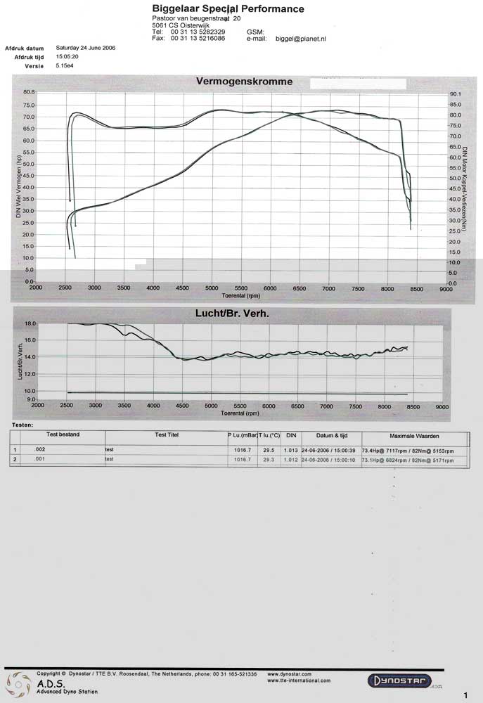

PostPosted: Sat Apr 02, 2011 4:41 am
Posts: 362
Here you can see some 907s curves.
The green curves show my 907 before the conversion, with 130tkm on the odo.
The red one is the much "younger" 907 with lower mileage.
The Blue one is the same one with slightly optimized engine.
(This bike is for sale, it is the frame # 2000)
/Edit: You see KW. To get HP, you have to multiply the values by 1.36
On this picture you can see my 907 engine, compared to the first run after the conversion. This was with a Multistrada 1000DS-2-Valve-mapping.
Its sad i have no torque-curve and the later, optimized curves saved.
