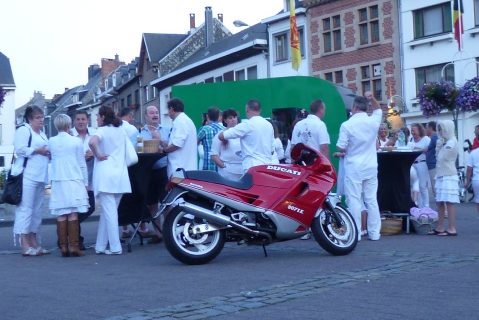

On road in Belgian Ardennes
File comment: on road in Belgian Ardennes
