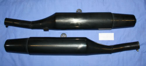

no, they won`t unless they are modified. The header of the Paso is unique as the exit tubes run parallel under the frame while on all other Duc they run outwards. Hence while seen from above the Paso silencers bend outwards all others have an inwards bend.
Paso (shown from the side so you can`t see it very good)
750S

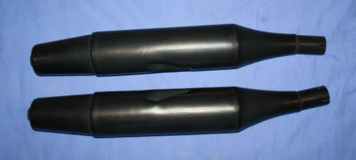

Here's what the motad system looks like anyway. The pipe from the rear cyl. is standard. Access to the drain plug is a bit awkward.
