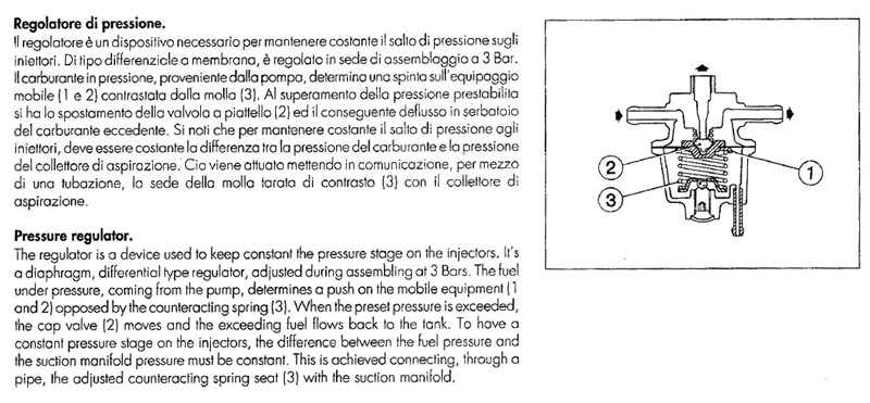

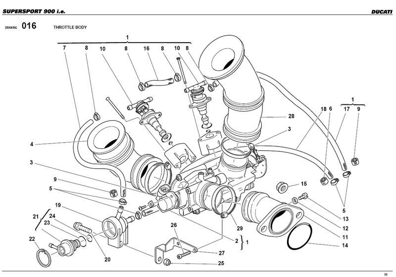

Thanks for the replies just a question there is a small pipe routed from the regulator to the the intake what is its purpose, only aftermarket regulators I have seen haven't got this outlet and have only a supply and return. Thanks again re Alistair :thumbup:
 Post subject: Re: fuel pressure regulator best place to buy in UK
PostPosted: Mon Mar 02, 2015 9:19 pm
from the wsm

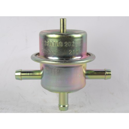

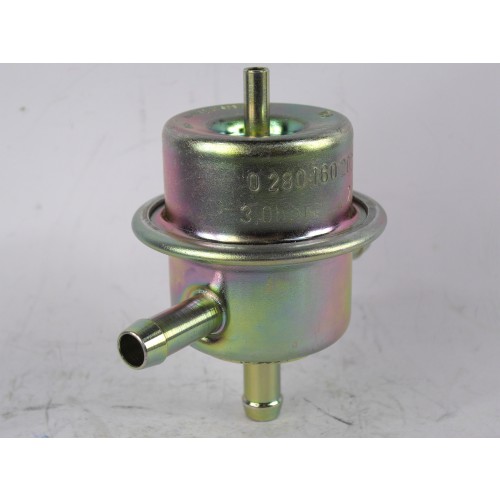

what I found:
Bosch 0280160202
(It should be verified that the hose connections are the same to be sure this is not a dual outlet or whatever! So this is just a lead to pursue. Connectors are for 8mm fuel lines)

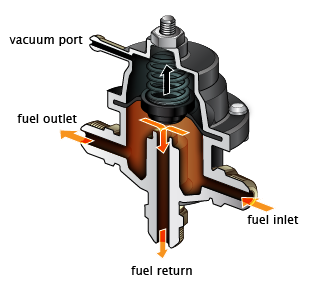

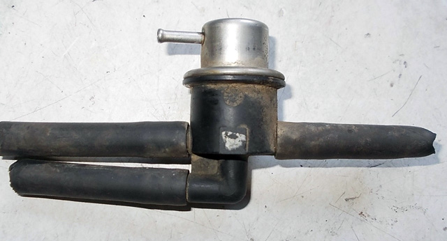

why didn`t anyone point out that the picture in the wsm actually shows the wrong kind of fpr? It shows one with an IN, RETURN and OUT (+ vacuum) hence a fpr that would be positioned before the injectors.
I was looking at the parts catalogue of a 900SSie and noticed the fpr was actually behind the injectors hence has only an IN and RETURN (+ vacuum) and that it is the same on the 907ie.
It is 3 bar as well. So it would be a suitable option. The fpr sits in a housing (830.1.091.2A - http://www.desmoduck.com/search.php?par ... 0.1.091.2A) other than i.e. on the ST2 where it`s in the whole tank assembly where the fuel pump and filter is.
