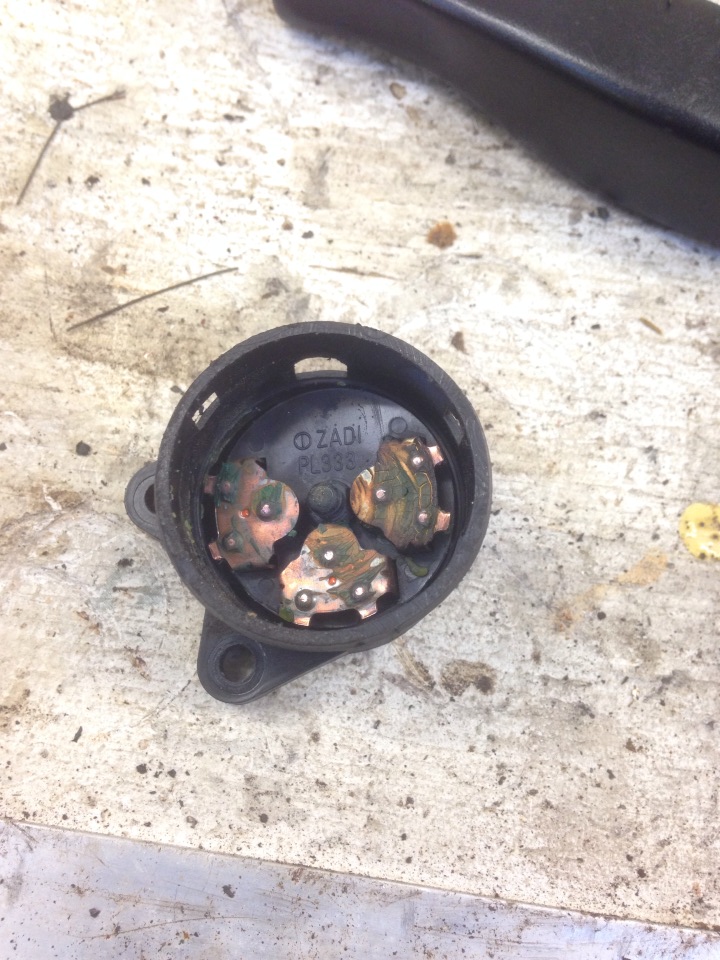

Took my ignition switch to bits & you can see what it was like inside. 907 ignition switch.jpg [208.7 KiB]
Downloaded 115 times
907 ignition switch 2.jpg [47.98 KiB]
All cleaned up & switching away happily now.
