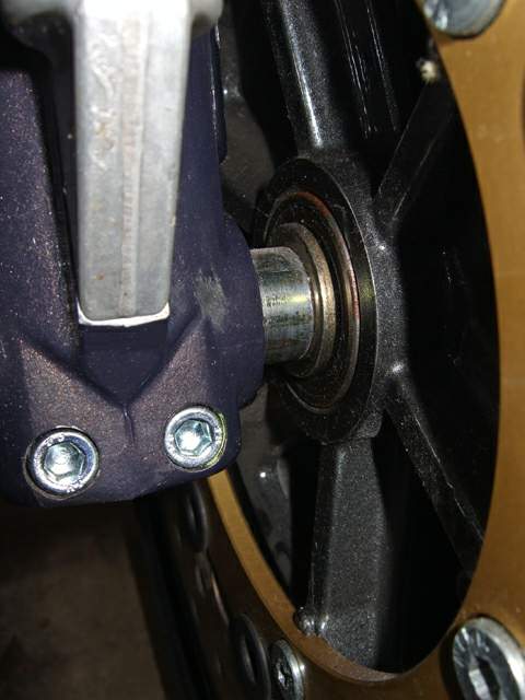

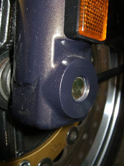

Taking apart the 907 to put on a new front tire and discovered a few things I wanted to get your input on.
1. the pistons on the calipers are further out on the outside than the inside. It kinda suggests the rotors could stand a bit more offset. Everything is stock, and both sides match, so I guess its a design thing.
2. the front tire is not centered in the forks. Its about 2-3mm to the right. Should it be that way?
3. On the speedo cable, there is a ferrule attached to the inside cable. Should that ferrule be on the top by the speedo, or down on the bottom by the axle? Mine was on the bottom, but I always thought that they should be on the top.

Phil,
do you have the washer on the right side of the wheel?
The ferrule of the speedometer cable should be on the top. It determines how long the end of the cable is that sticks into the intrument and also prevents it to fall out if you remove the bottom end.

Thanks G.
I will switch the cable around, which is where I too thought it should be.
On the front wheel alignment, I am a bit puzzled. The axle threads into the left fork leg, drawing the wheel to the left fork leg and the right leg floats in alignment (until you tighten the pinch bolts) So a washer on the right hand leg seems pointless to me. The wheel alignment is set by the speedo drive side, so I would think that the washer should be on the left side, if anything.
Wonder why they would add a washer to the right side? It wouldn't change the alignment of the front wheel. It would only affect the length of axle sticking out of the right leg. It would infer that the axle dimensions were not correct ( across the length). I wonder if its an adaptation to put an earlier Sport or Paso axle on the 907. (not that Ducati would resort to stealing from parts bins from another model :)) The 907 fork leg is narrower on the left leg to accommodate the bigger speedo drive. I am assuming that the step lengths of the two axles is different. I'll go measure a few now.

PostPosted: Thu Dec 11, 2014 6:26 pm
I don`t think the right fork leg floats into alignment. I guess the washer makes sure its alignment is correct.
If that washer were on the left side it would offset the whole wheel to the right.

G,
With all due respect, and there is plenty due, one leg of a motorcycle front suspension must float into alignment, and the other side is the reference. Otherwise, you will have binding of the forks. On the Paso and Sport, the left leg is the reference and the wheel is drawn to that side when the axle is tightened. Its more important that the fork legs are parallel than the location of the bottom of the right fork leg. If the right fork leg was not on the bike, and all of the rest of the parts were assembled, the front wheel would still have the same alignment. The manufacturing tolerance are such that you can not predict the overall stack of all the parts, so adjustment/float is left in the system.

PostPosted: Thu Dec 11, 2014 8:55 pm
I understand and agree with that but if you remove the axle I bet the gap between the fork leg and the rim is exactly the width of that washer.

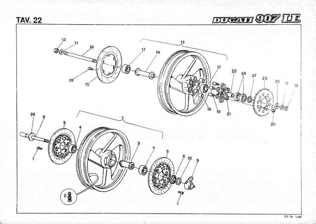

from which parts catalogue is that ?
 Post subject: Re: Oddities
PostPosted: Fri Dec 12, 2014 11:31 am
edited from the manual
PostPosted: Fri Dec 12, 2014 11:40 am
:lol: that`s so typically Ducati. The bearing spacer is also different in both drawings. According to the design of the brake discs I guess the picture from the wsm shows the early 907ie with 300mm discs and the picture from the parts catalogue the later 907ie with 320 brake discs.
Why one shows the washer and the other doesn`t will remain a mistery. :truck:
(but then sometimes the same pictures were used in different wsms i.e. 900SS or parts catalogues so you can`t always rely on them)

First, the ferrule on my speedo cable has always been on the bottom. Even when I got a replacement, it was on the bottom. I know what you guys mean about it being at the top to keep it from sliding out, but the ferrule would also be acting like a bumper, only letting the cable go so far into the speedo gear, and as the cable snakes around things as it gets to the back of the speedometer, it needs some slack/play. Seems like it could work either way. Just a thought.
My front axle has a washer, on the right side between the bearing and the shoulder on the thickened part of the axle that goes through the right fork. If you screw the axle into the left fork all the way with the speedometer gear in place (no washer on that side), the speedometer gear acts as the spacer on the left side. The wheel must need the washer on the right side to get it to center, remember the shoulder on the right side of the axle, the washer can only push to that point. I went through all this after a wreck and had to rebuild the front end and get the alignment back in order.

PostPosted: Sun Dec 14, 2014 3:54 pm
The position of the wheel in the fork is only determined by whatever is on the left side of the rim. If you have no, one or three washers on the right side doesn`t make a difference regarding that. This only impacts the position of the axle.
