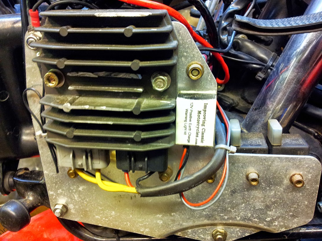

Having had troubles with my voltage regulator, which turned out to be the connector from the alternator, last year fitted a MOSfet voltage regulator from a Multistrada 1200. It 3-phase but I just left the other connector with nothing connected and it woks fine. It's rather larger than the original regulator though and I had to fit it on the outside of the aluminium plate that it mounts on along with the ignition amplifiers. Clearance was a little tight so I had to cut back a couple of the cooling fins to clear the mirror mounting screws and the indicator wires. It has plenty of spare capacity though so I don't think overheating will be a problem.
One of the drawbacks to using a modern regulator is that you lose the charge warning light function and I didn't like having a dash light that didn't work. To sort this problem I used a charge warning light from
Since the the warning light on the 907 (and all other Ducatis) is switched on the earth side I needed a positive earth kit fitted between the warning light pink wire and ground. The guy who sell the kits was very keen to help and supplied the kit ready to fit with instructions for earth side switching, as he called it.
Turn the ignition on and the light flashes twice to tell you the unit has powered up correctly and then the light stays on. If instead it repeatedly shows two short flashes followed by one long flash, the battery is flat and needs charging
Start the engine and the light goes out when the alternator is detected as working and producing sufficient power to cope with demand and keep the battery charged
If the light repeatedly shows one short flash followed by a long pause then this is warning you that the charge regulation system has failed and the battery is being overcharged.
Quite clever and more than just a voltage controlled switch and for only £15.88 + delivery I'm very happy with it.
I also managed to fit a slimline HID ballast where the old regulator used to with an H4 dipping HID unit in the headlamp. So i've vastly improved the lights as well as the efficiency and reliability of the charging circuit.

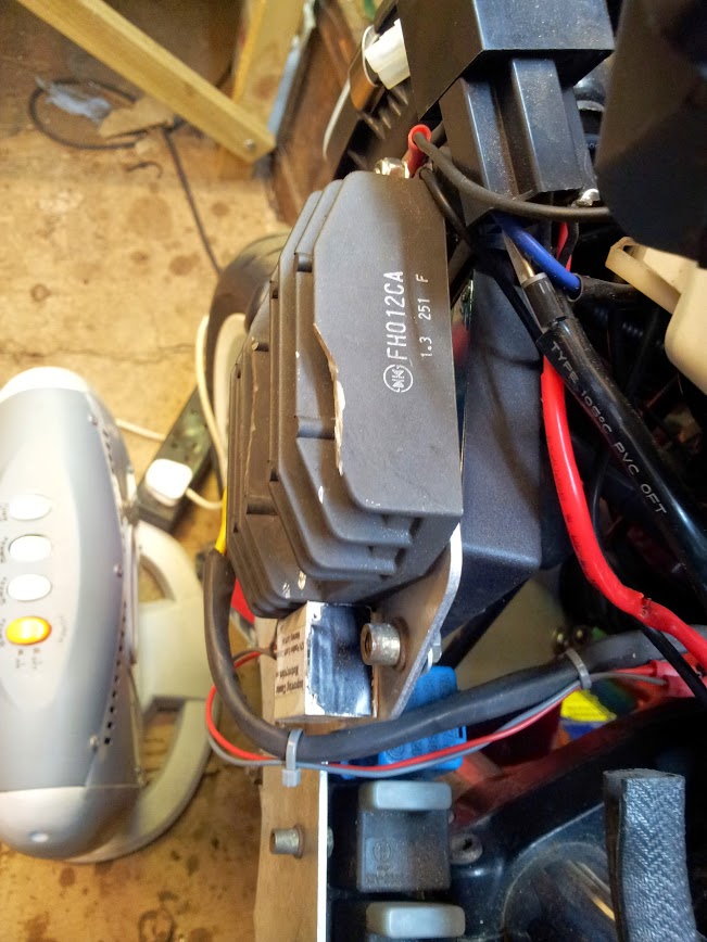

He doesn't seem to sell regulators, only fitting kits. The FH012 which is shown on his site is the one I used.
