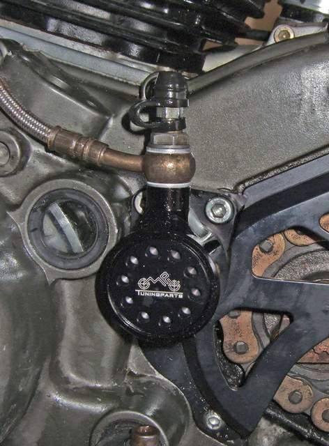

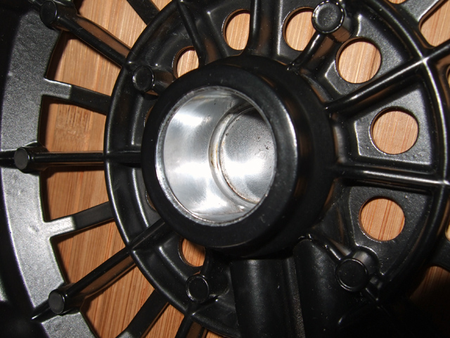

One of the issues that came back with the 907 after it's holiday of 9 months was a dead clutch. The Clutch master was still full of fluid, but no pressure when the lever was pulled. I t bled out OK, and clutch was back, but has been slowly getting softer as time goes by. Pumping the lever daily keeps it all operational, but it is a bit of a pain. So first thoughts are to put a kit through the Master cylinder, replace the Slave cylinder and while going mad, replace the clutch line with a braided line. The Master cylinder kit is on the way, and both links in G's first post are still active. Was going to stump for the US version link, but the pictures show it only has one connection for the bleed valve and line connection. The 907 slave has 2, one for each. After looking through numerous parts lists, later clutch slaves use a dual purpose banjo bolt, that adapts a M6 bleed valve to it. Pretty much a dual purpose fitting.
The question is, do the billet slave cylinders come with this fitting? Has anyone purchased either of the above, and had all the bits and pieces to put it all together without having to run around like a blue a**ed fly trying to find the parts.
The other part I wouldn't mind putting through the clutch is the clutch repair kit, Part no.: 19520023B. This is the same part that is modified to suit the 750/906 with a roller skate bearing and removal of the seal. Again, has anyone changed this part in the clutch? Is it as simple as removing the slave cylinder, pulling out the old, and pushing in the new, or do you need the fingers of a brain surgeon to dismantle and reassemble?
