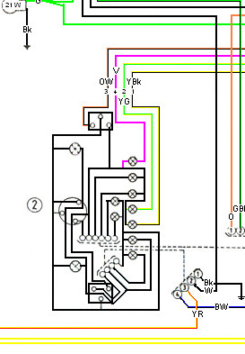

PostPosted: Fri Mar 04, 2016 11:02 am

there's another option - if the top mount for the dash fails the dash flops back and can break the PCB track where it rubs against whats left of the mount.
