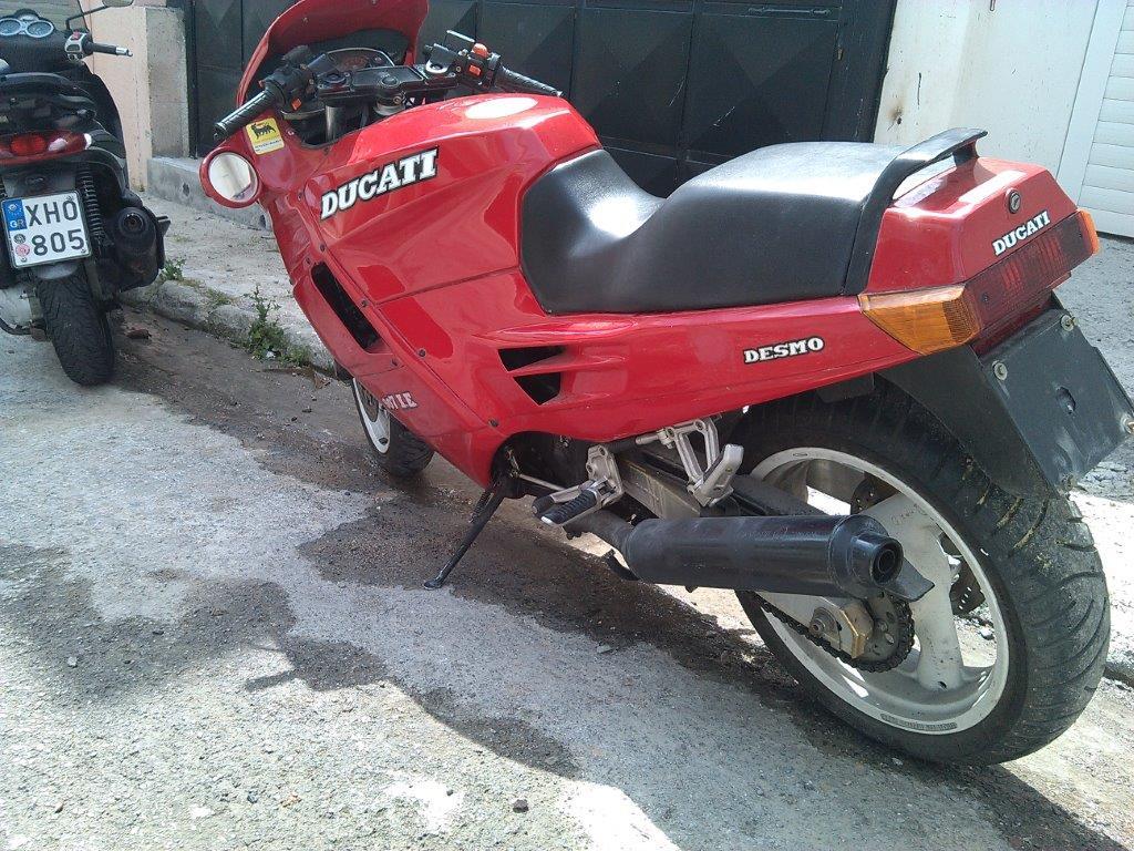

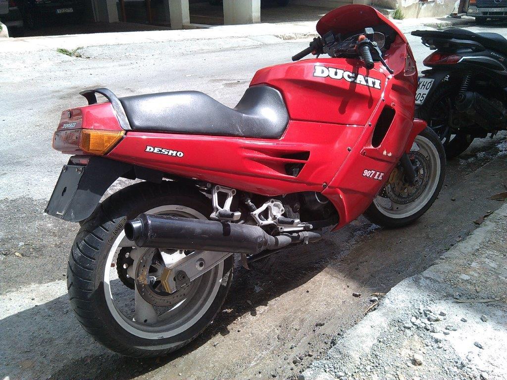

Hello everyone!
I was very happy to discover this forum as I will be able to share my experience and get some techical advice for my newly acquired 907 IE!
It is a low mileage bike which I got a few days ago.
The reason I decided to go for it was to have an old schoοl bike, reliable enough to enjoy riding long distances locally and abroad.
For the last 11 years I have been riding a 1972 Norton Commando 750. It is a lovely bike which I really like but always gave me a sense of insecurity regarding its reliability.
Of course there are modes and upgrades that make it more reliable but I'd rather keep it original.
Hopefully this is going to change with the 907 although from what have been reading, it will need some improvements
Both mirrors have suffered damage and the left hand side one is completely broken. Hopefully it can be repaired. I did manage to find front blinker lenses (also broken) for both sides from ebay.
The bike starts immediately and the engine idles even when cold without choke. There are no strange sounds when running...apart from the dry cluth.
There seems to be something wrong with the clutch though(disks stuck maybe due to prolonged inactivity).
I don’t know if they can be unstuck and cleaned or if they have to be replaced.

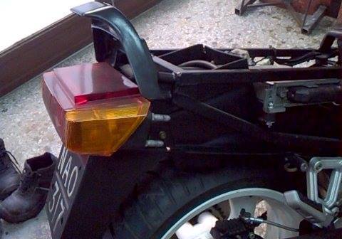

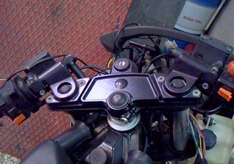

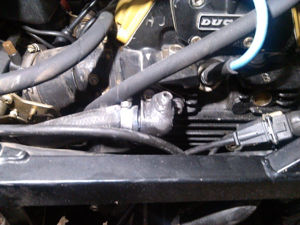

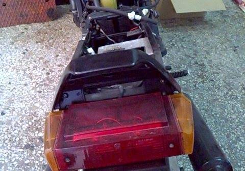

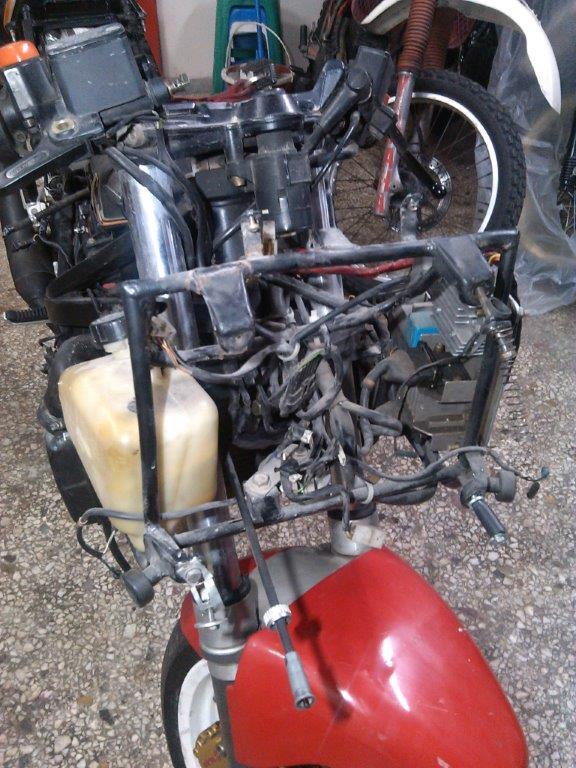

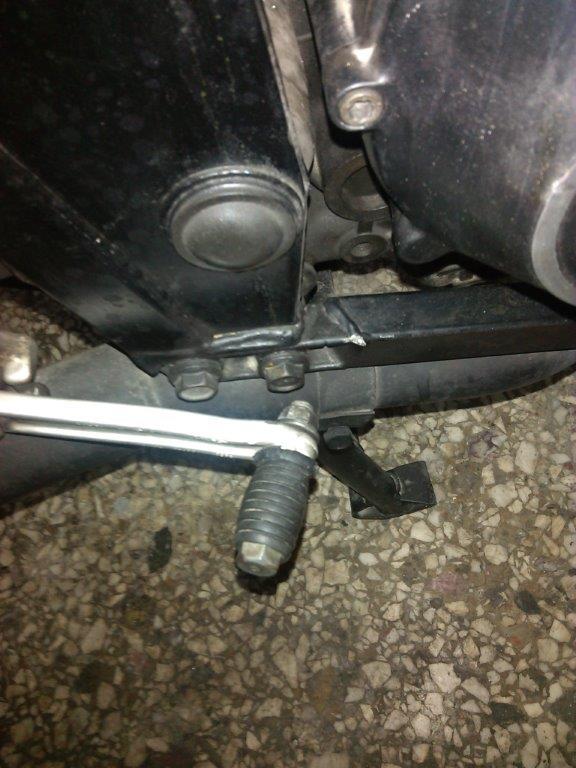

Soon as I took it to my workshop, I decided to remove the plastic panels to get a better look inside only to find out that the right hand side ones have been repaired after getting damaged in an accident.

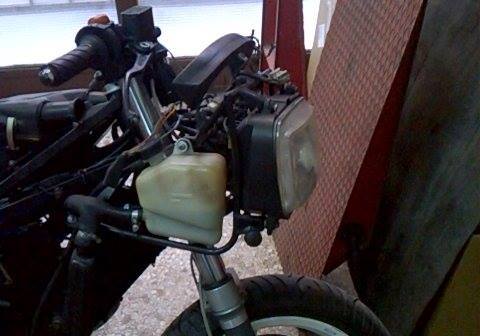

The frame doesn't seem to have been affected by the accident but the headlight mount is bent and I will need to find a good straight one. The coolant tank was broken and glued and the instrument cluster is not in its best shape.

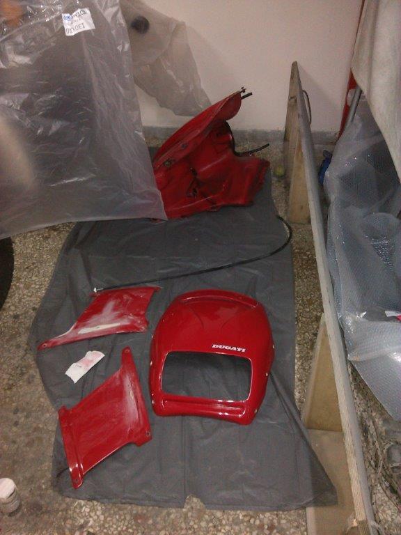

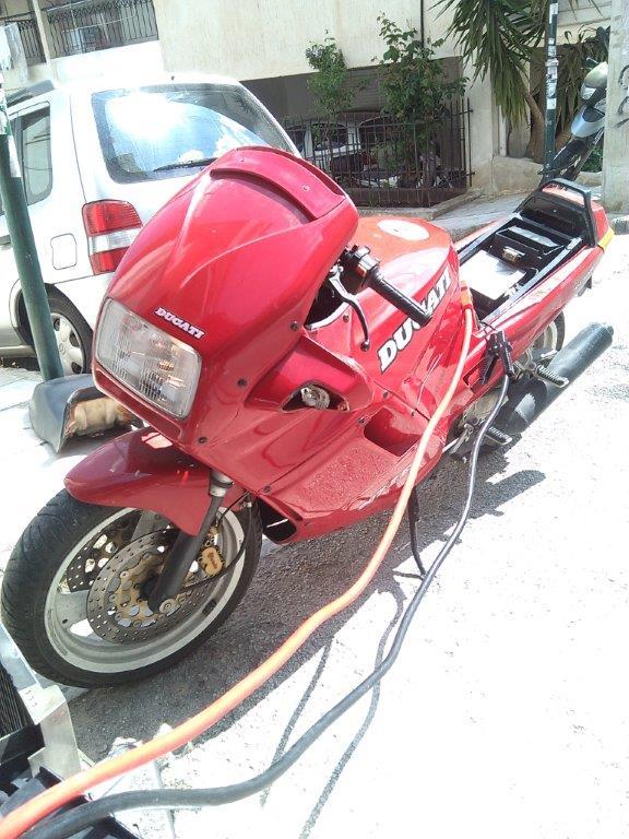

The panel repair is very good but the paintjob quality is poor so I decided to respray everything but the petrol tank which is in excellent condition.
I started preparing everything and also began making a list of the parts I will need. The aim is to make all necessary repairs and a good engine maintenance so it can be ready for the summer.

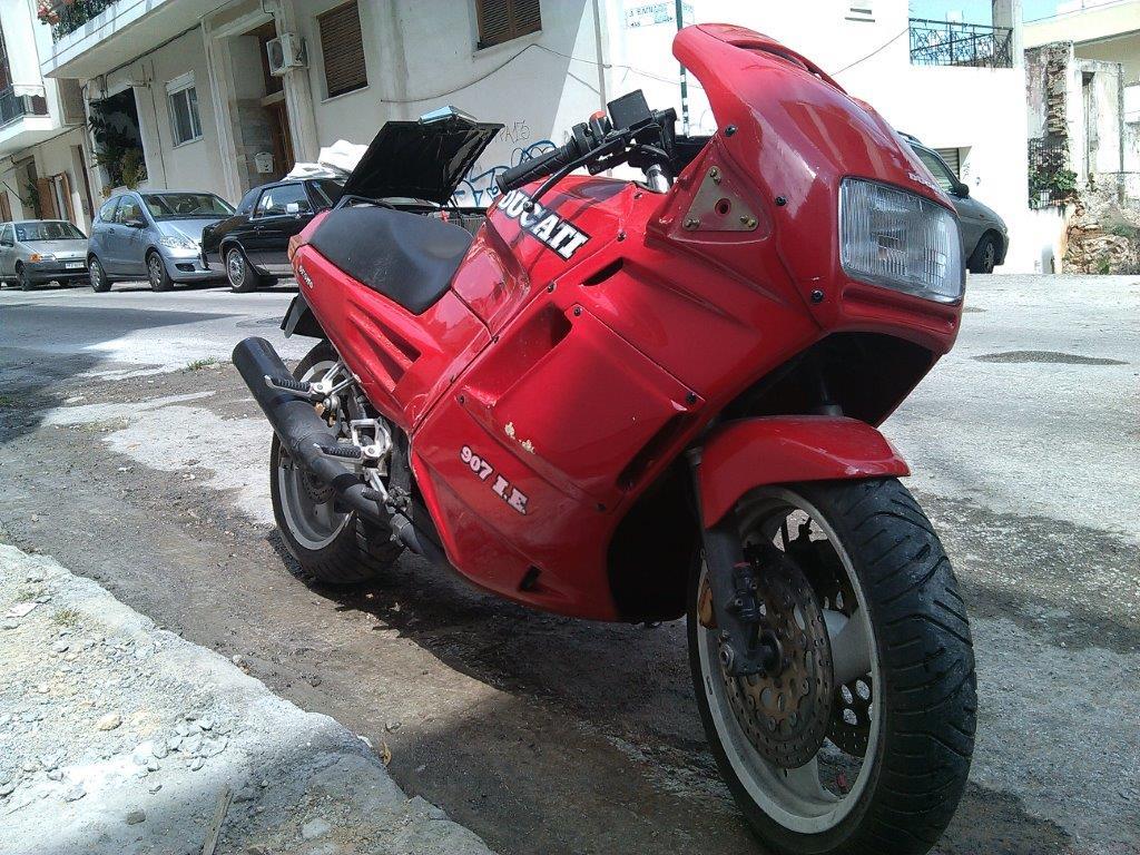

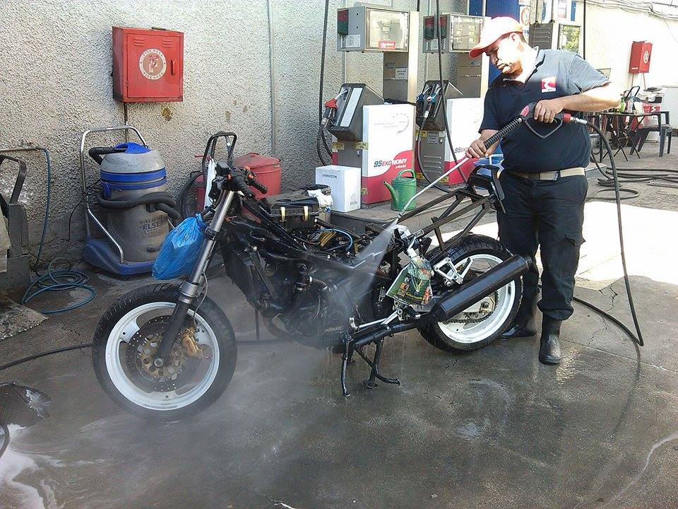

Didn't have time to do much since the last post but last week has been quite busy.

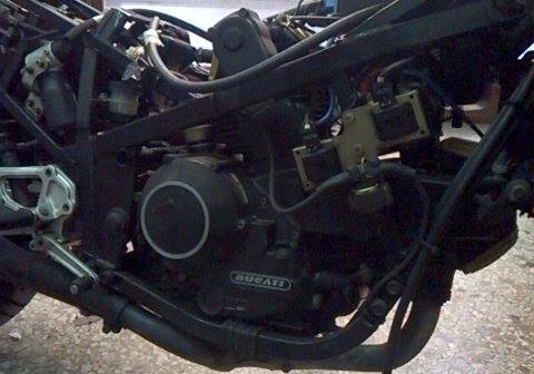

I removed as much stuff as I could and took the bike for professional cleaning. 24 years of dust and oil was gone. It needed some more manual work afterwards but the result is quite rewarding.
The frame section under the battery was corroded by battery fluid spillage so the plastic cover that holds the battery and goes all the way to the rear end was removed for gaining better access to the area.

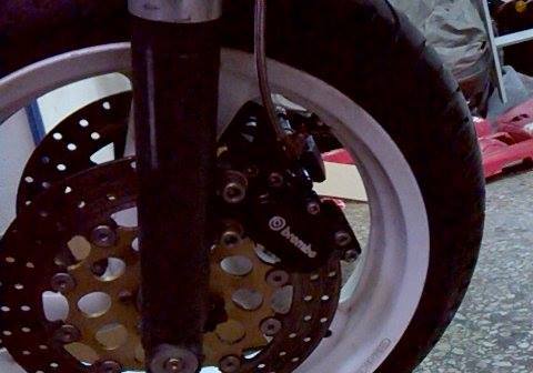

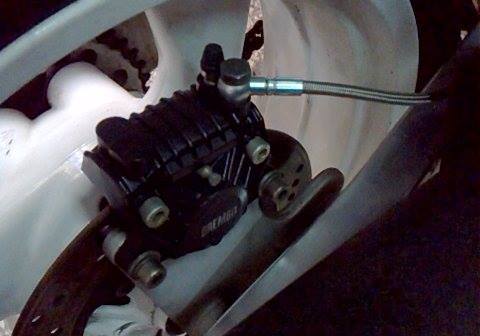

This was a good opportunity to respray various black parts such as the corroded part of the frame, the rear grab bar, the brake calipers, upper fork plate, side and main stands etc
The front sub frame was damaged and was replaced by a good straight one from a 906 after cutting the voltage regulator plate mounts from the 907 sub frame and welding them to the 906 one. The result is quite satisfactory with the 906 sub frame looking exactly like an original 907.
The wiring harness had some really bad job done in the past on its plugs and connections so I repaired and secured everything. Also the thick wires from the battery to the starter relay and from this relay to the starter have been replaced by new and better ones.
All vibration dampers of the ECU and alternator mounting plate have also been replaced by new.
The coolant bottle has been replaced by a good used one and the coolant hose modification will come next, soon as I find a CBR filler neck.

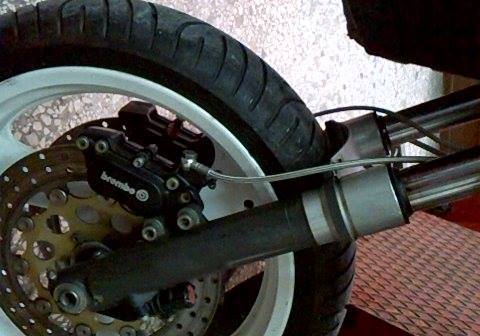

New steel braided brake hoses have also been fitted all around.
Plastic parts are now ready for getting their new coat of paint.
After a failed attempt of having the decals made by a local shop, I managed to find original Ducati ones through the Italian ebay so problem solved.

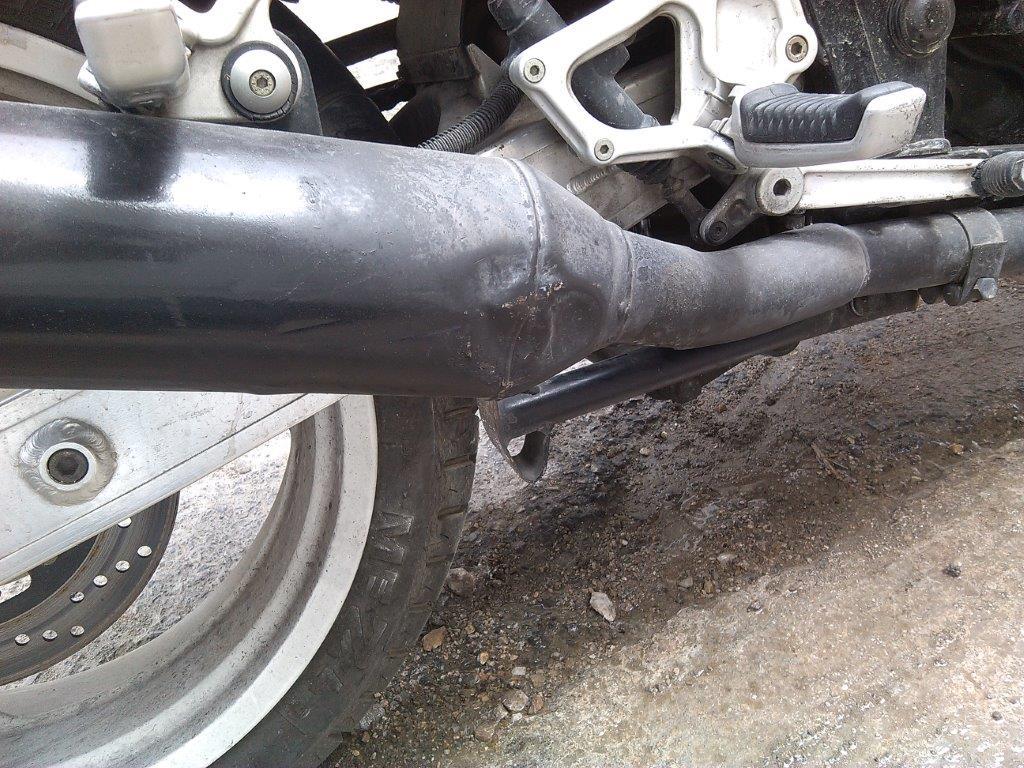

Two ways to fix the dented exhaust.
1. Find a way to block both ends and inflate to around 80psi and then take a blowtorch to the dented area, starting at the outside of the dent and work your way to the centre.
2. Find a way to block both ends and fill with water. Place in a chest freezer and check every hour (you don't want to leave it in there long enough to pop any welds).

Thank you for the excellent ideas for repairing the dented exhaust!
I was planning to remove them anyway and spray paint them with satin black high temp paint.
