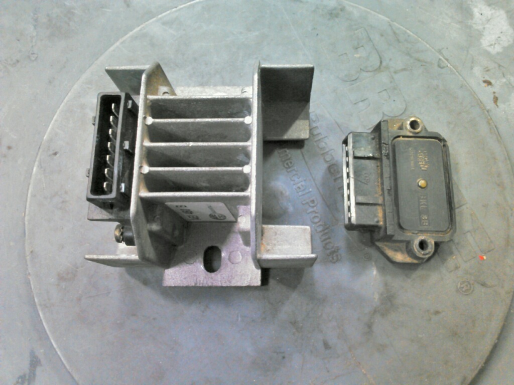

Does anyone know where to get a replacement ignition amplifier? One of mine went bad. It is Ducati part 28740011a. It comes as a set of 2.
Does anyone have a spare, or is there an aftermarket mod? The initial search here only brought up a post about not destroying any ignition parts with a multimeter....
The bike started running on one cylinder, and the local guru says this is the culrprit.
It is not the same as the infamous voltage regulator, or is it?

based on poking around and comparing how these look.....i might have answered my own question. Another vicitim of interchangeable terminology. If they are the same I know where the FAQ is and that roadstercycle.com has them....
Sigh.....

Ed Miltch @ has a set now,not the same as the regulator
if I understand what you need

if you google Marelli BKL 3B you find lots of info. Seems these parts were installed in sevral european cars and there are alternative modules.
A list is in these two auctions:
http://www.ebay.com/itm/HUCO-Ignition-C ... r#shpCntId
HUCO is HITACHI
http://www.motorpartsworld.com/parts/ignmaumpw188915
