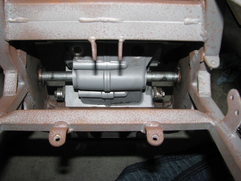

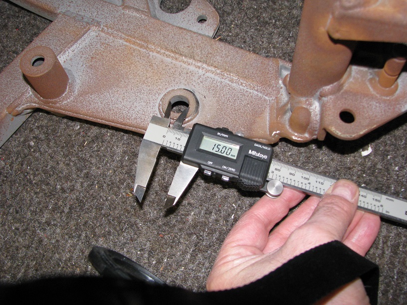

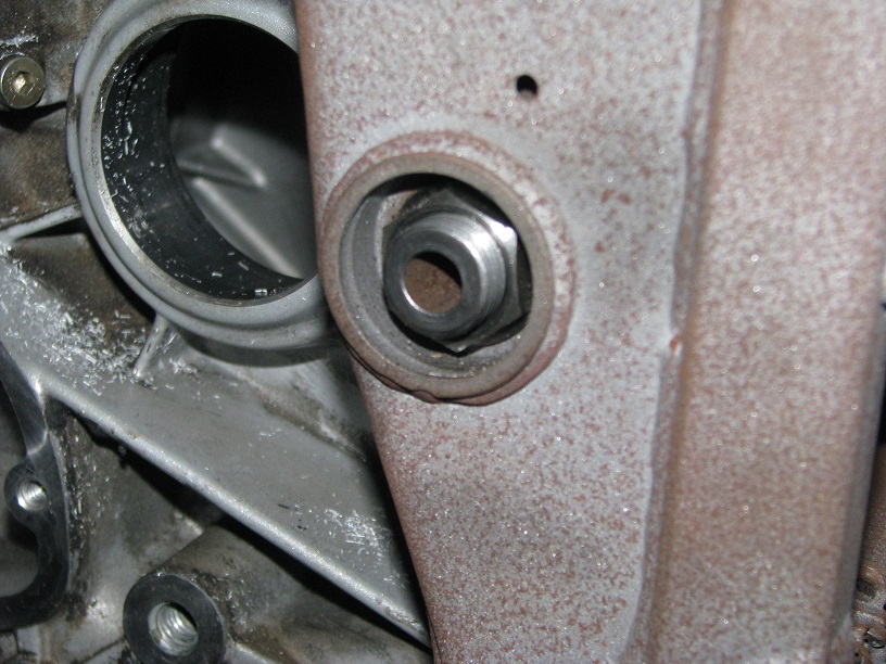

I found that the Paso has a 15mm swingarm pivot. That is very small especially considering that all other Ducati models since 1990 they have used a 20mm pivot. So I decided that I wanted to upgrade.
This would require modifications to the frame and the bearings in the swingarm.

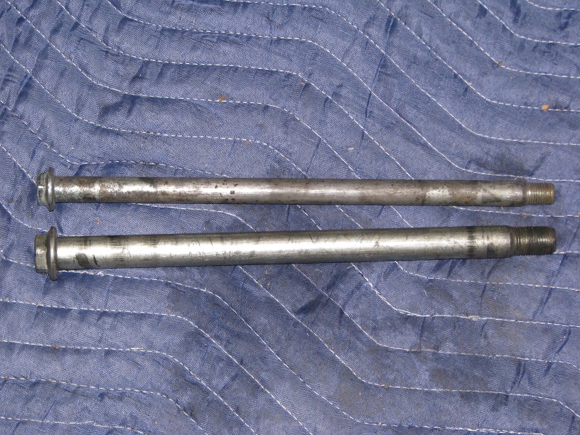

I found a 20mm axle from some Japanese bike was very close in spec to the Paso pivot.

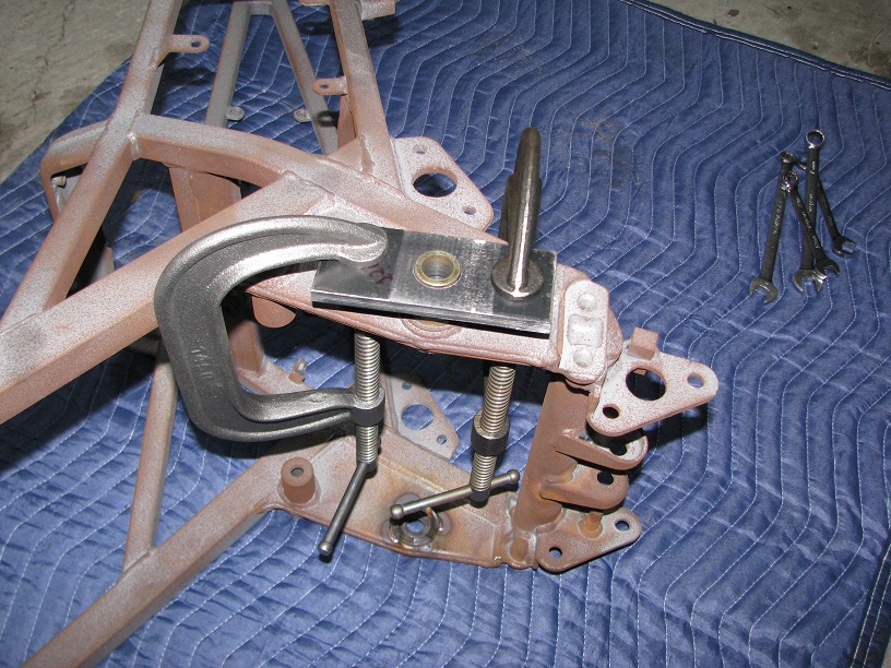

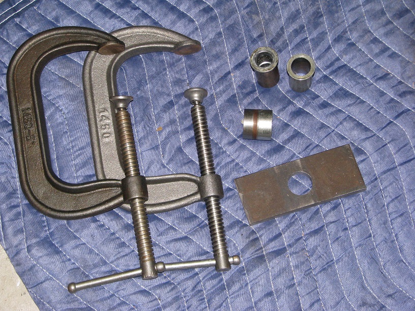

My plan was to bore out the frame but it was impossible to fit in a milling machine. So I made fixtures that allowed me to drill out the holes in steps.

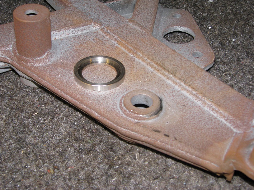

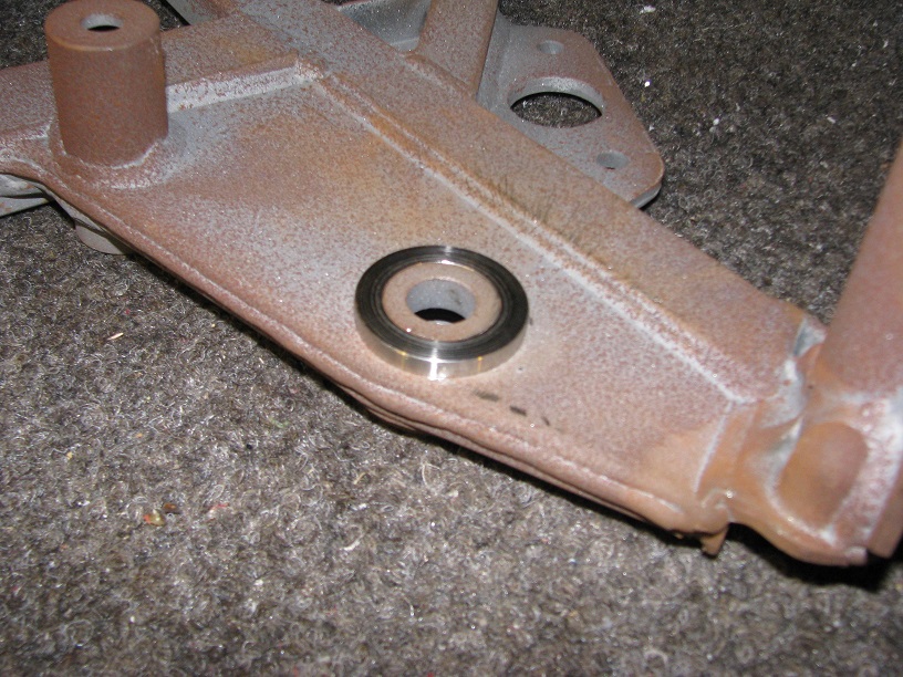

Measuring the inside of the frame I realized that there would be very little surface area left so I had cups machined that I welded over the original pivot area.

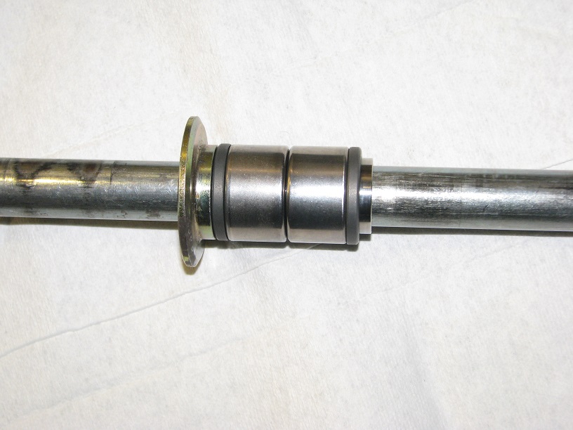

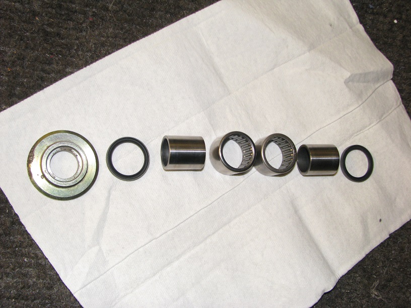

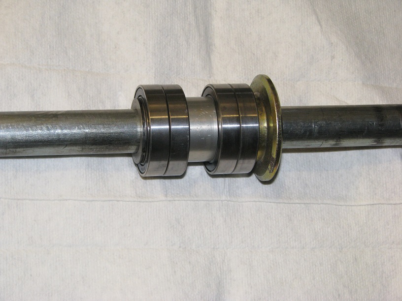

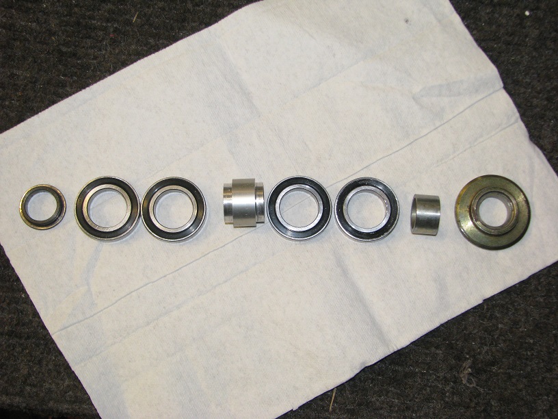

Modifications to the bearings in the swingarm were pretty straight forward. Sourced some new bearings and made a few new spacers.

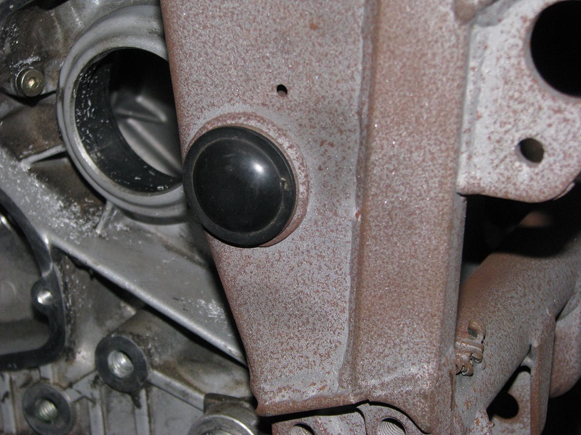

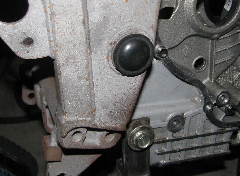

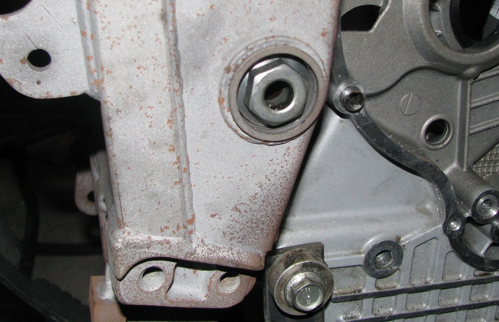

I had to turn the head of the new pivot down slightly to fit down the frame pocket.
On the other side I had to source a small OD flange nut.
Everything fit so I could install the black plastic caps.

Speedmade, don`t mind me asking but seeing that the thread of the 20mm pivot is longer I wonder which part of it sits in the frame. Hope you get what I mean. (if it`s the threaded part it could cause radial play, which may be gone if all is tightened up, but still...)
