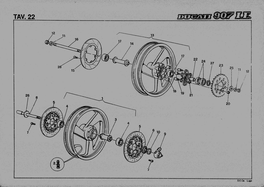

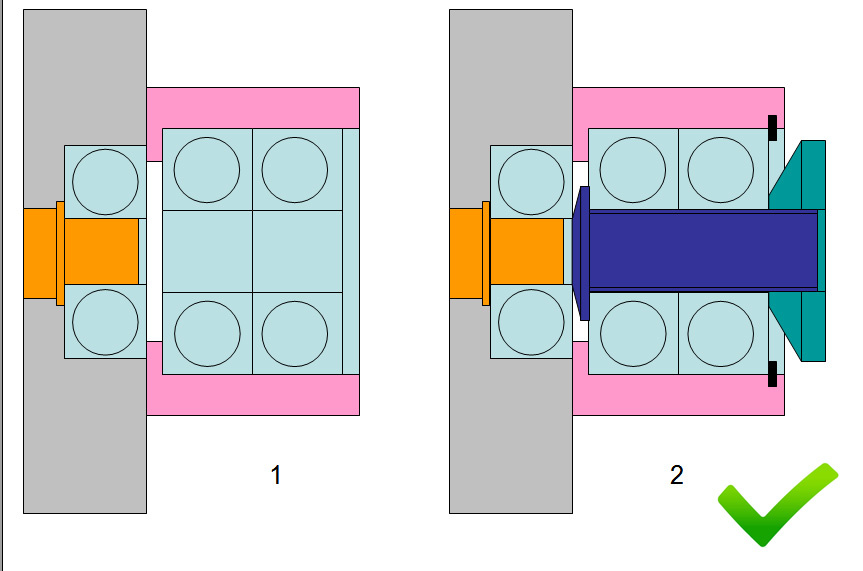

A while back , I removed the rear wheel, new tire, cleaned up everything, checked bearings etc...put it back together, no issues.....until....I was perusing the parts book and noticed the spacer assembly is not the same....in the image, spacer 22 has a groove for circlip 27. My part 22 does not have a groove, no circlip and it was installed backwards, otherwise there is nothing to hold the bearing in.....my question is, can the cush drive be installed backwards?...is the parts image wrong?....I put it together the way it came apart, didnt notice anything strange, no excessive play or binding.....

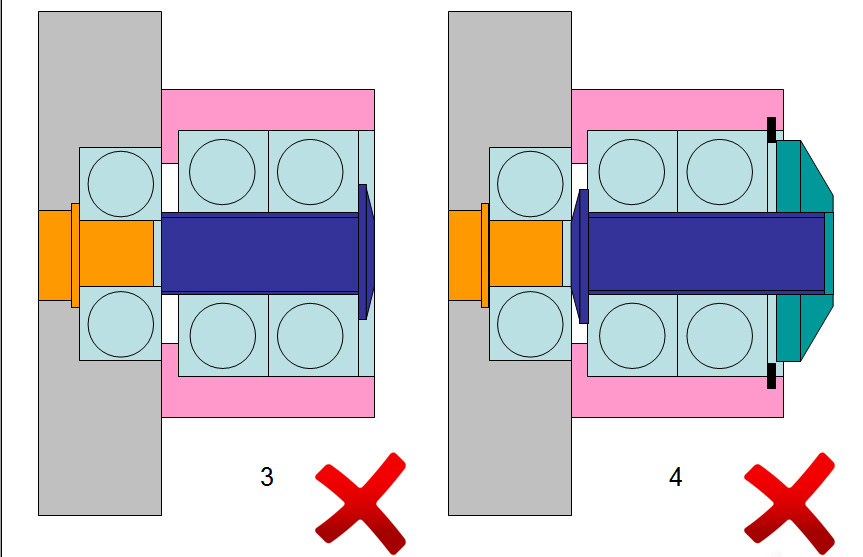

 Post subject: Re: Rear wheel bearing question....
PostPosted: Mon Mar 20, 2017 11:48 am
this is from a Monster. It shows the circlip and corresponds to drawing 2

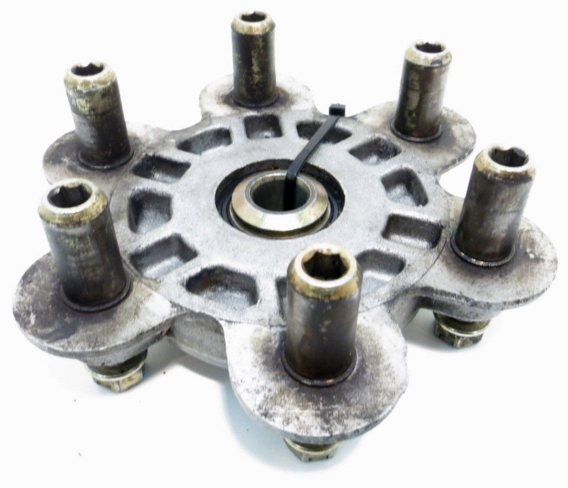

I had mine off to fit a new tyre last week. As said above, the circlip holds the bearing in place.

O.k I see now....I am missing the circlip and the outside spacer #25....... thanks, G. Next ? is, does someone have a spacer to sell....?? Or dimensions.... Circlip I can come up with.....

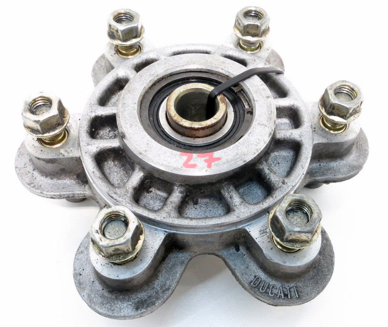

How was the wheel installed if you don`t have spacer #25 ?!

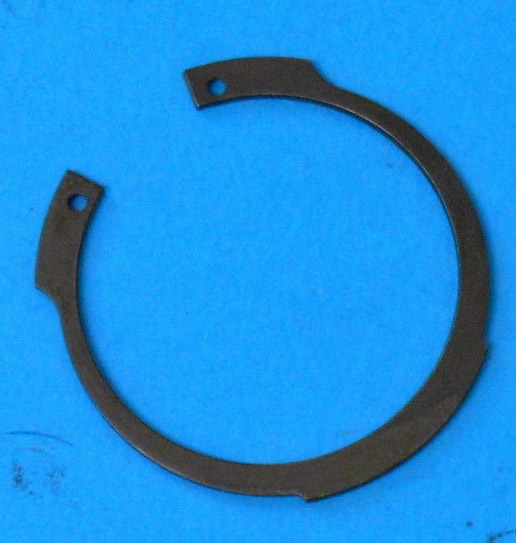

If you look at the Stein Dinse online parts catalogue you find that that spacer is #71310321A and was superseded by #71310321B.
If you click on the "order" link you get to another site that shows a picture of it and a list of all Ducatis that use the same part. In this case:

You can buy a used one for $20 on ebay or visit or call your local Ducati dealership and have them order a new one for $13.58. The circlip (#88440011A) which is used on the same bikes costs $2.10. (on ebay at least $10 incl. shipping :banghead: )

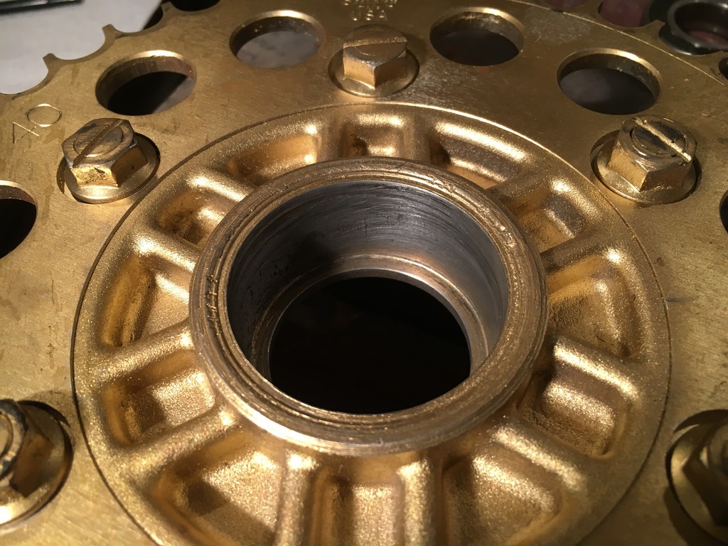

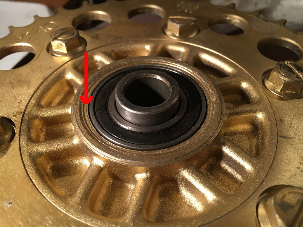

Honestly, nothing is easy in my life these days.......here's what I have, explains why I didnt realise I needed a circlip.......
Bearings are 47mm, 25mm, 12 mm, which I'm guessing are wrong, I would think 10mm would give room for a clip.....so was it machined out for some reason? I suppose I should find a housing and do it right......what say you?..

Now, looking at the picture Gerhardt posted, I think it was machined down to the original groove...I wonder why....

You are too quick on ordering parts. Another look at the Stein Dinse online parts catalogue would have shown that the bearings are 6005-2RS1 which are indeed 47x25x12mm.
Did the bearings sit correctly and which depth does the sprocket carrier measure?
PostPosted: Tue Mar 21, 2017 9:21 am
Comparing your sprocket carrier and the picture I posted I notice something.
Your spacer sticks out more and the center of the sprocket carrier is not that high. The top area has a marked surface and isn`t flat. There`s one area that could have been the circlip grovve. So for whatever reason some material may have been shaved off the sprocket carrier.

maybe that damage is a result of installing the conical swingarm spacer (25) the wrong way around with its wider side towards the sprocket carrier instead of towards the swingarm.
Doesn`t seem likely tho if the spacer is 45mm in diameter as mentioned here: http://www.ebay.com/itm/Ducati-Rim-Spro ... 2005220150
