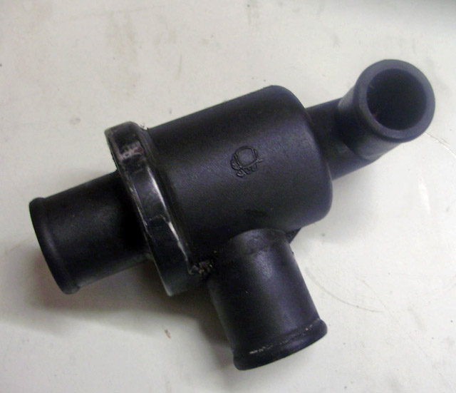

If a suitable manufacturer of hoses can be found, how hard would it be to re-route the hoses so a more common thermostat can be used? Not sure what type off a later bike would suit, but from memory, the 996 has a straight through connection, rather than the right angle that is at the top of the 906/907.

The 916/996 and also the STx, S4, S4R all use the same thermostat. It also has the right angle connection but is on the wrong side from the 906/907 (kind of hard to explain). The 906/907 thermostat is also the same as the 851/888.
I have an alternative idea to use the radiator from an ST2/4 which would do away with the pressure to the header tank but the top hose is on the opposite side so would need the plumbing re-arranged but I reckon it could be done. If the thermostat housing was changed to the later type with the hose to the thermostat facing forward instead of up it could probably be done using hoses from other Ducati models. The inner edges of the fairing air ducts would probably need trimming to clear the edges of the curved radiator but that wouldn't be seen.
Sorry I've gone off at a tangent from the original post.
This is a 916 thermostat. (on a 907 thermostat the upper tube shows to the opposite direction)
