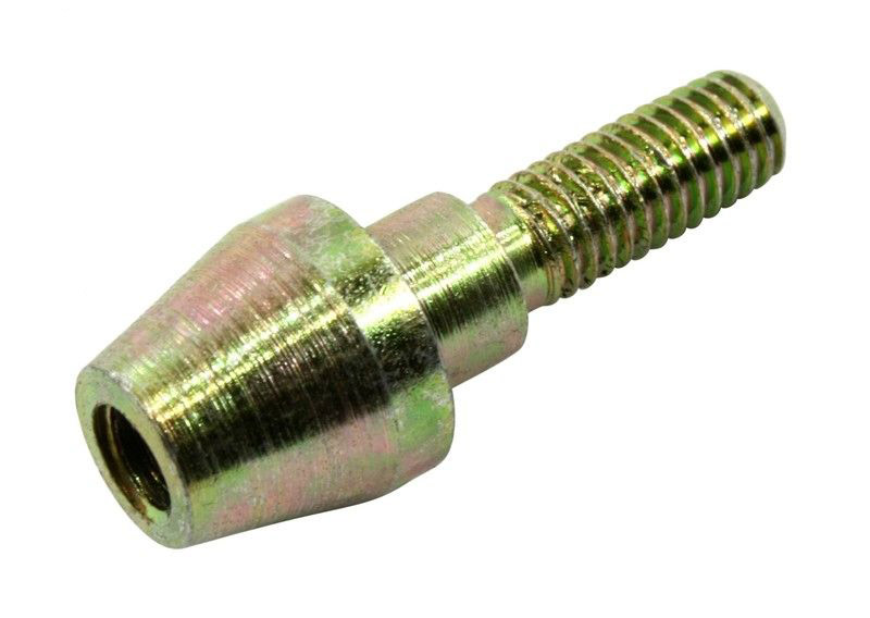

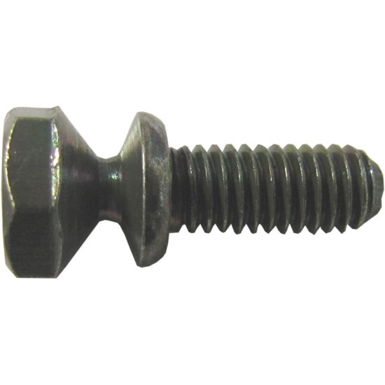

It's not stupid. Ducati and other bike manufacturers use them. It's an antitheft measure. There are different types. Some have a hex head that will break off once the bolt is tightened (bottom picture). The 907IE and several others used the conical bolt.
The are several ways to remove those bolts. Screwing another bolt into the conical bolt and countering it with a nut is unlikely to work. You should remove the triple clamp from the bike first. Then you can use a file/angle grinder or Dremel to create two flat areas so a fork spanner can be used to undo the bolts.
Or if that doesn't work you can screw in a hex bolt and weld that to the conical one.
Another option, which I guess won't work tho, is screw in a hex bolt with high strength Loctite. Maybe the Loctite is stronger than the torque of the conical bolt.
