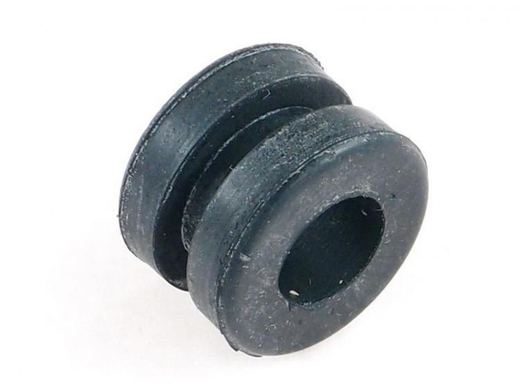

Hi Spencer,
Fo you mean these (037072020)?
These are readily available (new, freshly produced) at around $1 (Stein-Dinse.com).
Assume either Ducati dealer or Bevelheaven (California) will have them on stock ...

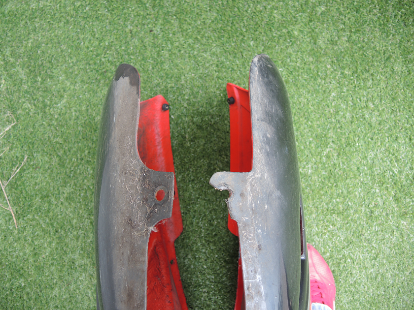

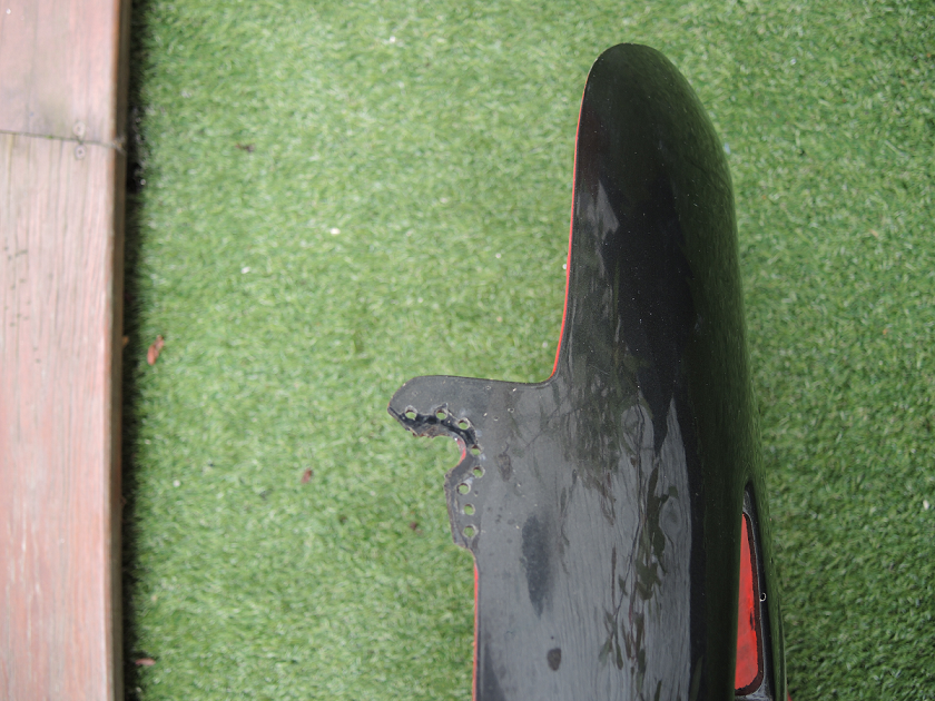

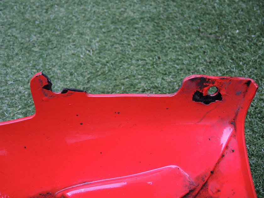

Hi,
I used Teroson 9225 UF ME (UF = Ultrafast, don't take the SF, Superfast, as it does not cure fast enough for this application. ME = Micro emission) for repairing my 750 Paso's fairing.
http://www.loctite.co.uk/loctite-4087.h ... 2654093313
Underneath half of the mounting bracket was missing. So I sanded it up, grinded the edges to increase the surface and create space, drilled a nice line of holes to get a strong bond, cleaned everything and applied the Teroson product.
It is an ultrafast curing polyurethane which you apply using a plastic foil. Hold the foil in such a position that you can fill it up with the product. Keep it still and let it cure for 60 - 90 seconds. After full cure you can file and sand the workpiece in the desired form and paint it. Worked very well. Also very useful for repairing cracks in fairings.
I’ve added some pictures, but unfortunately I haven’t taken any of the end result. So you’ll have to believe me on my blue eyes :)
