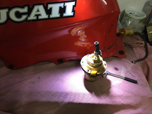

Things are starting to look different in respect to the source of the problem.
I replaced the spark plugs and swapped coils.

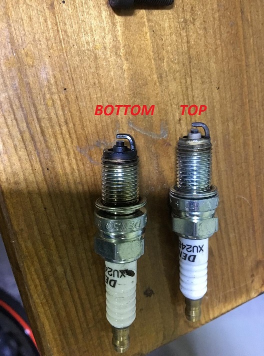

I didn't get single cylinder operation (maybe I didn't ride it enough) but I noticed the same thing as before when I removed the spark plugs for inspection.
Top cylinder spark plug is white and too lean and bottom is black and wet.
I am starting to think that the reason the bottom cylinder stops working is due to fouled spark plug.
Tonight I removed the injectors to send them for inspection and cleaning.

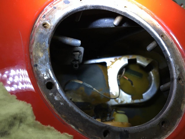

I also removed the fuel filter precautionary to replace it from inside the tank only to find out the anti-vapor valve to be disconnected. I don't know if this could be the source of the problem though.

The workshop informed me that they were not at their best shape. I also removed the fuel filter only to find that it was COMPLETELY blocked! I really don’t know how fuel was passing through it.
I don't know if all those could be the source of the problem but they are definitely issues that needed to be solved.

 Post subject: Re: No spark on one cylinder!
PostPosted: Wed Jul 31, 2019 7:47 am
Ah well! I'm sure that's a big feature of the problem. It's so easy to assume that the sparks or lack of them is the trouble.

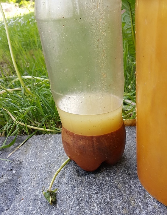

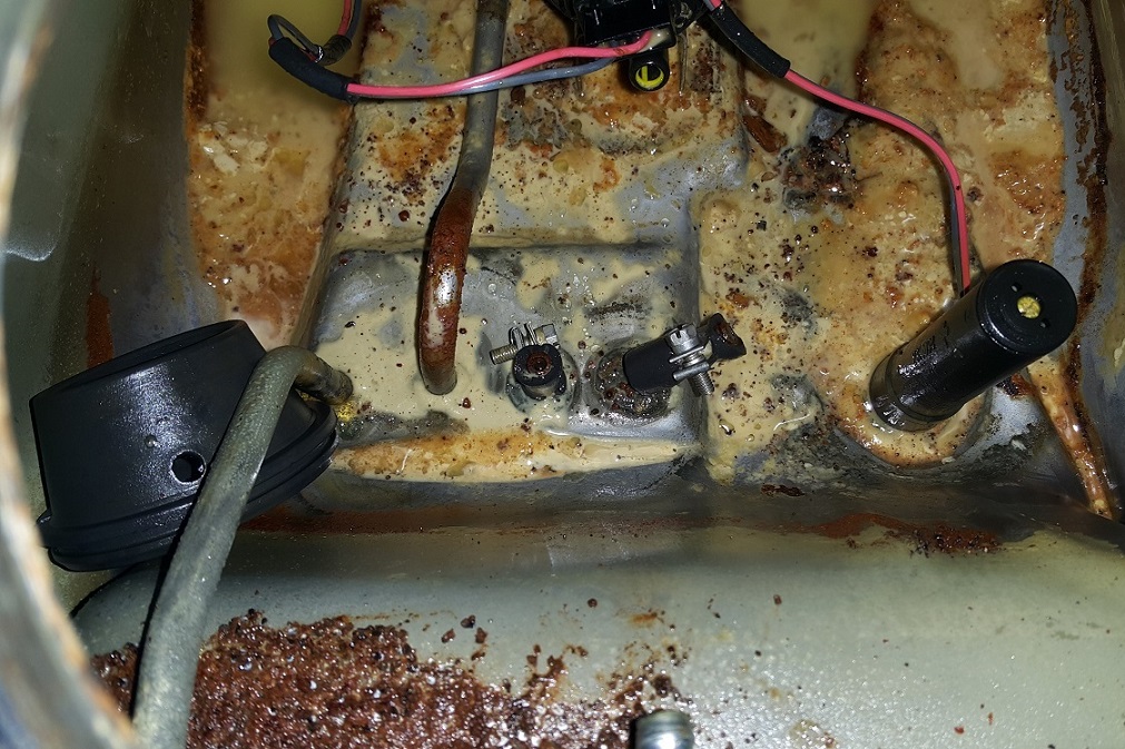

I finally find the time and as soon as I look in the tank I immediatly see something I dont like.... I start taking out the fuel and I I find.... shit, literally...
Pump, fuel sender, all was clogged. the vent hoses from the fuel cap to the tank were missing and the connections inside bloked by rust and muck, I am not sure how the fuel did not go out (it if did it would have been a very nice big ball of fire...) inside the tank all hoses were bloated and the pump mesh filter was full of muck.
I disassembled & cleaned everything, 2 hours later it started perfectly...
I am still at a loss, how is possible the thing could run with all that water and mud... plus, the injectors are in series.. why was it running with one only? I dont get it.
Now the bike is fine, I hade to refurbish the tank and I might need a new TPS, or just some tuning (has a small flat spot at 1/3 of throttle at 3500RPMs)
Thank got it was fully bloody serviced... :banghead: :banghead:
This little story just to underline the fact that often we dismiss the simple things...
Here are pictures of the tank and the muck I too off, the bottle was a 1.5L just to give the idea of the shit that was inside
