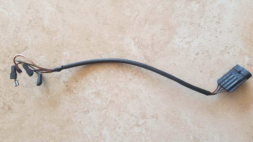

File comment: This is the harness in question. The sheath and the exposed wires are stiff as a board.

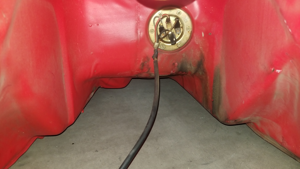

File comment: Too bad it had no heat shielding.

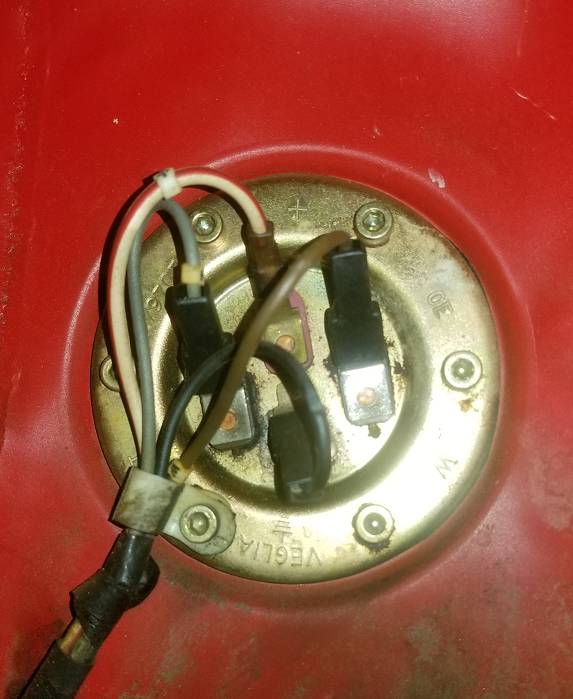

File comment: The wire colors are not all the same as shown in the color wire diagram. All except the black ground wire change color at the 4 wire plug. All but the ground wire have tiny plastic lettered identification labels around them. These can be moved to the new wires.
V --> W/R (White with Red stripe) = + 12V, label +
Bk --> Bk = - Ground, no label
B ---> Br = Fuel level sensor, label W
Y ---> Gr = Reserve fuel level sensor, label T
