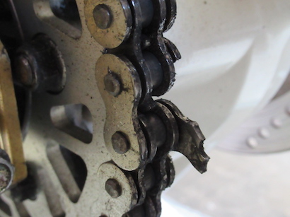

Just fitted new chain and sprockets, the old chain was broken partially. Had luck that I saw it just in time.

File comment: broken chain

I hope you didnt get the same chain , looks light weight ,like maybe for a MX bike. Could be why it broke , also could be over tightening chain.
