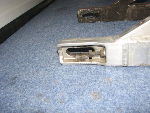

I have an aluminium swingarm from one of the first 1200 or so 1991 750SS bikes. I was keeping it for a worthy cause but your project bike sounds like one.
These first few 750SS bike had a narrower case at the pivot than the 900 and all later 600/750 SS bikes (no needle bearings), and was the only version of the 750 that came with a dry clutch like the Paso (with the clutch slave cylinder in the RHS clutch cover). The arm is the same outer width at the rear wheel as the later SS ones but has a narrower inner width. It has aluminium spacer tubes integral at the pivot end to line it all up with the narrower cases. Maybe it was taken from leftoever 750Sport parts?
I wonder if it with fit? The good news is it will take a 17 inch wheel.
Maybe if you send the width measurement you need at the cases I can check? I'll dig it out and send a photo.
Mick

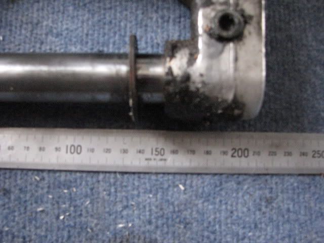

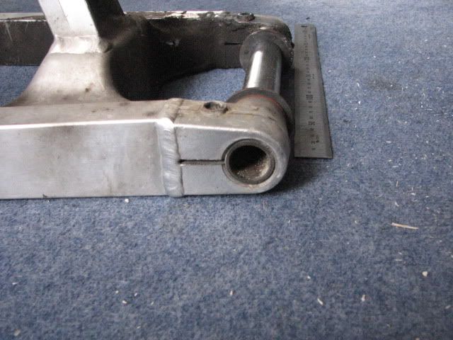

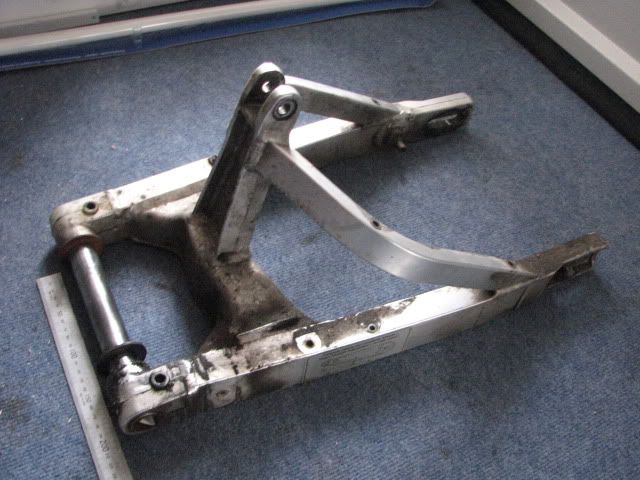

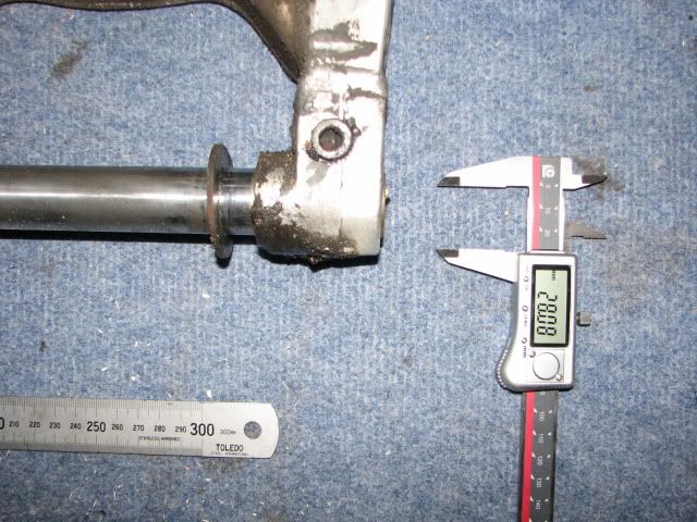

The swingarm I have is about 155mm between the pivot ends and takes a 28mm OD pivot (which I do have with the arm, and is much larger than later SS bikes which had the needls bearings in the case). See photos:
No cracks in any welds than I can see, but I've not cleaned it and looked hard yet.
Let me know if it would be of use and we can sort out arrangements offline.
Mick

Wow, that looks exactly like the later model SS swingarm on the 900, except that it takes a bigger pivot pin, and the space between them is much narrower. Not as beautiful as the Verlichi part, but it should work just fine. I would think that if you really needed to, you could use an SS swingarm, bore out the pivot pin holes to hold the larger pin, and add some spacers to fill the gap. Machining of course is the trick. How to get those two holes aligned so that the look right at eachother? A good machinist is needed.
I have a 750 Sport that a previous owner had adapted the steel SS swingarm to it. They cut off the two forward sections, bored them, then welded them back on. I assume they used the pivot pin to align the two pieces while welding to ensure alignment.
