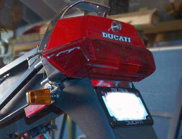

Can someone tell me how to tell the difference between the two? And if you replace the US version with the EURO versions is there much work to do the conversion?

EU taillight with amber/red lens and incorporated turn signals
US taillight all red with external turn signals (the taillight has no reflectors for turn signals)
Fitting the EU taillight on a US bike is moretheless plug and play.
