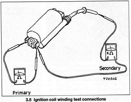

This leads me to a question for a non electrical type tho, how do I read the resistance to confirm that my ones are bad?
I have a multi meter and got a bit of an idea how it works but what plugs in where to get the readings??
Thanks, Rob.

we sent a mass mail to every registered member. I`m wondering why some of you didn`t get it.
You find it here viewtopic.php?f=1&t=6429&start=15

No didn't get the email, but havn't checked my spam either so it may be in there. No worries, just curious and happy to hear all has worked out. Don't come on here too much but it's always helpful when I do.
Thanks for the diagram - makes perfect sense now!
