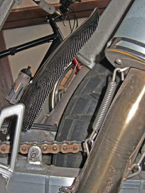

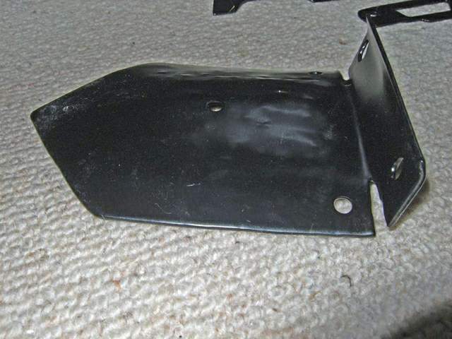

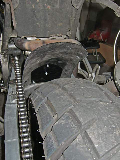

not quite sure what shape you`re after but if you figure out a way to make a mounting bracket you should be able to adapt almost any rear fender after cutting it to shape.
This for instance is something I made for a friends Cagiva Elefant. I had an old carbon rear fender from a Guzzi and cut it down over 50%. Then I made that stainless steel shovel to rivet it on. But that swingarm is flat so it`s possibly a bit easier to do than on a Sport.
