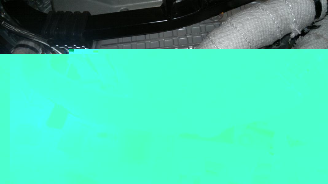

Then is was the headers` turn. They are good, but not good looking and too much heat emitting on the reat Wilbers damper and also heating up the space in the fairing.
Thats why i wrapped them in ceramic fiber cloth:
29012012714.JPG [77.36 KiB]
Downloaded 356 times
15042012868.JPG [74.23 KiB]
