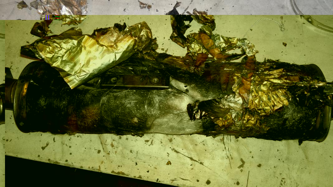

My exhaust cans are ready.
The old titanium tubes had dents and were not nice looking any more.
I replaced them w. carbon fibre tubes.
I tried some hours to get the damn thing open, after drilling the rivets nothing happend.
So i cut the tube.
13022012743.JPG [104.15 KiB]
Downloaded 356 times
Thats what it looked like iside:
13022012745.JPG [125.78 KiB]
And this is why i could not open it. The endcaps are welded on the center tube... (Marving)
13022012750.JPG [97.52 KiB]
