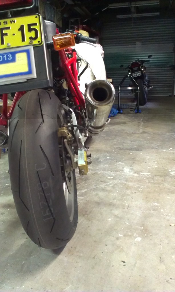

Well have finally ridden it, albeit only around the block a couple of times, (it is a very steep and bendy road around my block :lol: :lol: :lol: :lol: )
and it now steers in a very similar manner to my '07 CBR 600 RR, (blasphemy I hear site members crying :shock: ), which really was by the time you thought about a corner, you were already through it, and onto the next. :thumbup:
Phil your right about being able to change lines at will, it is a totally different bike to right now. :choo:
The brakes are better but still not right, so will put a seal kit through the 08’s, only thing I haven’t done yet, keeping in mind that this thing was in storage in Japan for I believe 8 to 10 years, so even though their well and truely bled, would imagine some sludge is still in behind the pistons, and it’s not a big job to do.
What’s Higgy’s line about making things worse.
So there it is, some tidy up to do here and there, and it is a track/sometime road bike with a bit of style chucked in to boot.
Peter
